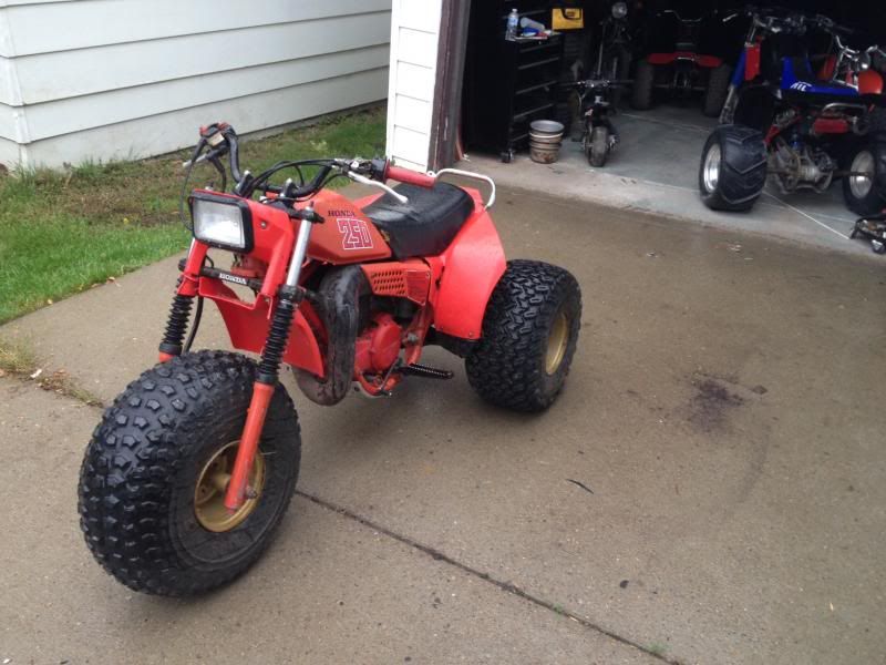

I saw this odyssey for sale locally and I was wondering if this one a home made job or a aftermarket job for rear suspension.

Cant really see much you have more pictures?

Only one he gave me. 400 bucks for 2. One is a rolling chassis the other one is torn apart for a restore. I was curious about it being a dual shock set up.
PostPosted: Wed Feb 26, 2014 11:40 am
Looks like they cut and hinged the stock frame and added some old motorcycle fork shocks. So the whole Engine & gearbox & axle float on that rear section.
Did you or the seller sit in it? Just wondering how stiff those shocks are, and wonder if it drooped with a driver in the seat. Wondering why they needed 2 identical shocks per side.
More pics would tell if it were done with pieces of structural steel (angle, channel, etc) by someone, or if it were more complicated as if manufactured.

He has pictures of it out and about. But no one sitting in it. It appeared to be a set of shocks on both sides of the frame. Image Image
PostPosted: Wed Feb 26, 2014 12:01 pm
Your going to have to take better pics than that I really cant see any of the suspension other than the two shocks.
You have the advantage you have already seen this thing in person so you already have a picture of what it is in your head, were looking at blurry dark pictures we cant see none of the details you already have in your brain and and interpret bad pictures using whats in your memory.. :-)

These are just the pictures that the guy had posted in the ad. I just passed on it being I think it is a hack job. Could have parted it out for more but I just bought a house so a little more important things.
