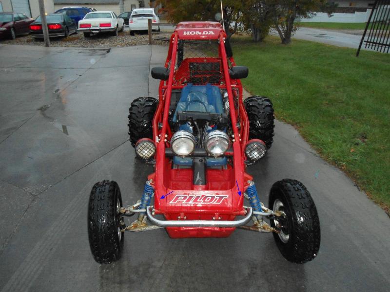

this pilot was on ebay and I really like the look of it. the panels look stamped and professional.
anyone know who made them and are they still out there?
http://www.ebay.com/itm/Honda-1989-Pilo ... 7675.l2557
PostPosted: Mon Mar 03, 2014 11:11 pm
Talk to Nickrnr or Shoubadaba. Nick had a pilot with a set of panels that looked just like that.

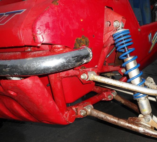

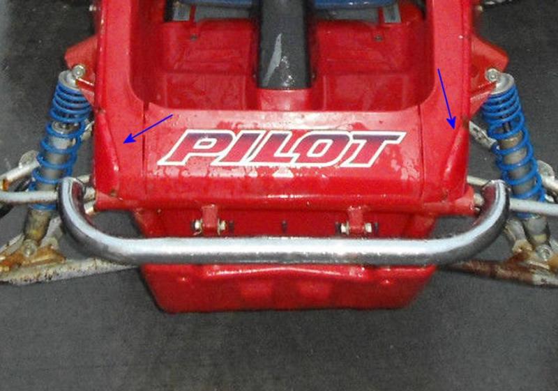

for those panels to work they had to remove one of the side "V" bars. take a look at the pics you can see above the parking break the bar is removed that's why the panels are smooth and clean.
PostPosted: Tue Mar 04, 2014 10:18 pm
I don't know who did them but they look good how they integrate into the foot tub. I would say lots of time and some welding went into them
PostPosted: Tue Mar 04, 2014 10:20 pm
Ditto, not an easy bend on the lower part either.

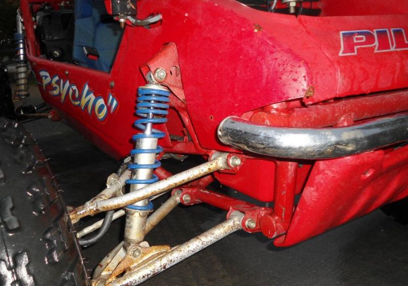

PostPosted: Wed Mar 05, 2014 9:53 am
Looks to me all they did was shave the front fenders down to about nothing then roll a edge on the panel so it would hug the plastic, hug edges are fast and easy.

The panels are metal look at the rust.
PostPosted: Wed Mar 05, 2014 1:54 pm
Online
Doesn't look like it was prepped very well before painting. I like the way the rolled the shape in the side - creating a depression. gives the sheet metal some strength.
PostPosted: Wed Mar 05, 2014 2:32 pm
You can buy a bead roller and do everything you see yourself at home in your basement its not that hard just takes time and practice, I have full access to all them fancy tools, bead roller, English wheel, planshing hammer, shrinker, I just have no projects that require their use lol
170 bux gets you started.
