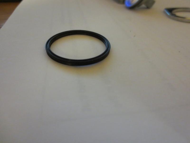

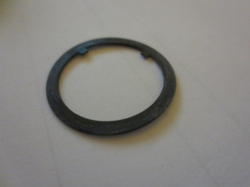

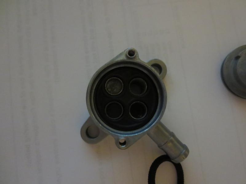

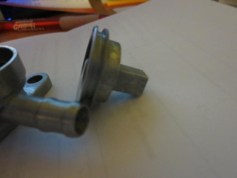

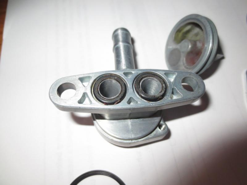

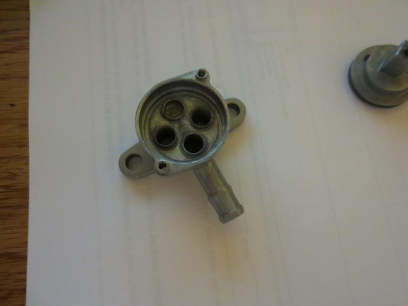

 Post subject: Re: Pilot petcock valve
PostPosted: Wed Jul 23, 2014 11:30 pm
Posts: 531
Location: Carson City, NV
Taking apart the pilot petcock valve.
File comment: O-rings were glued in.
PostPosted: Wed Jul 23, 2014 11:40 pm
Posts: 531
Don't be nervous about drilling and tapping the holes my wife did it. LMAO You must use a drill press. The drill size we used was 3/32". We did not have any problems tapping the part using this drill. It took some time filing off the rivet head. Once you remove the plate you can use some 600 grit sandpaper to deburr the part of the rivets that stick up so that the plate will be able to go back on easily.
