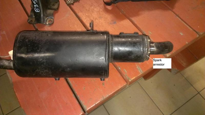

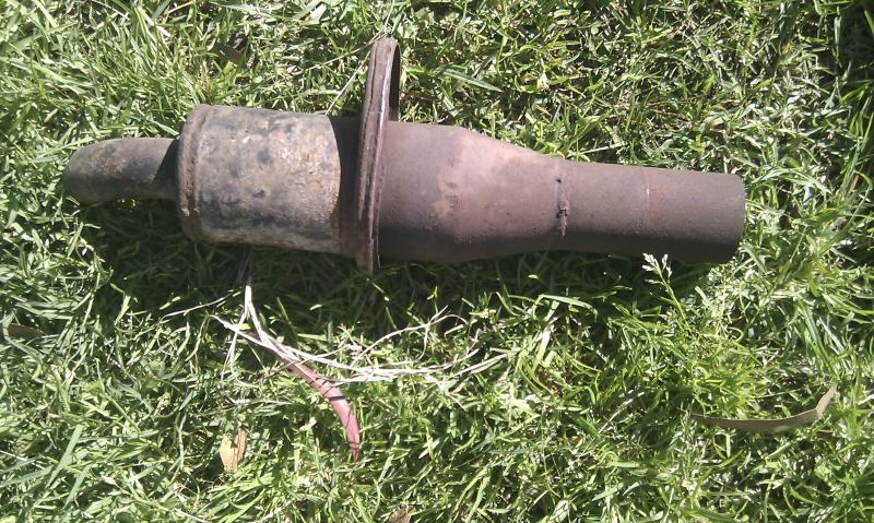

I while back before the Hacking incident. I had a post re Modifying one of my stock Mufflers
I cut out some of the internals. But got a little carried away and cut out the spark arrestor
I have now fitted a off the shelf arrestor and buttoned it up
sand blasted ready for a coat of paint tomorrow
When fitting a Muffler. IE FMF, DG Ear bleeder, Pro Tune etc
Should there be a Jetting Change
File comment: cut out a little to much
File comment: put a little back in

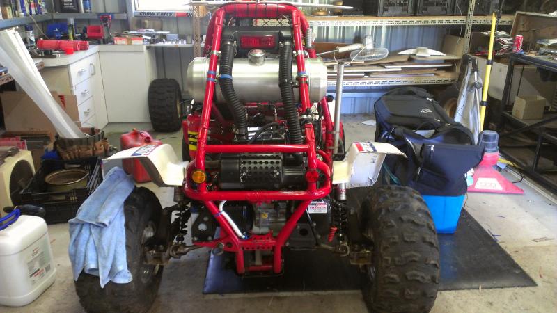

Were you running the intake modifications before you decided to modify the muffler?
PostPosted: Sun Jun 29, 2014 12:29 am
Yes
I did the air box Duel intake 5 years ago. and there was a big improvement with a Uni filter and
upgraded bits since then
I did the muffler mod after reading that it had been done before. May of been on this site or another
I had a spare and thought I would give it a go.
I liked the trying to keep the stock look of the muffler
