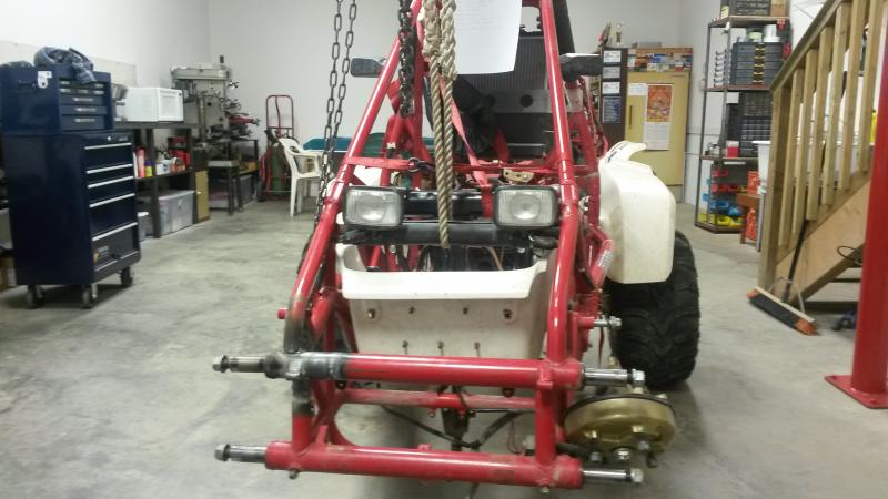

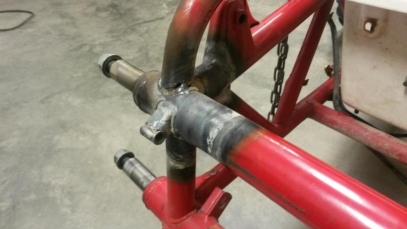

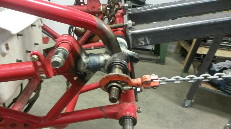

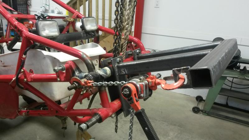

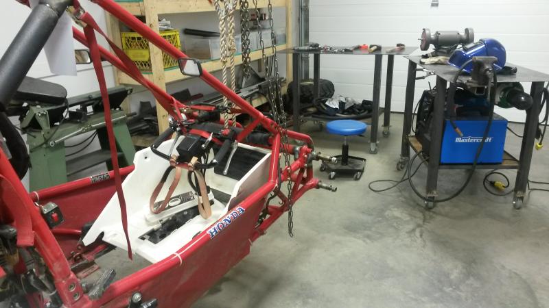

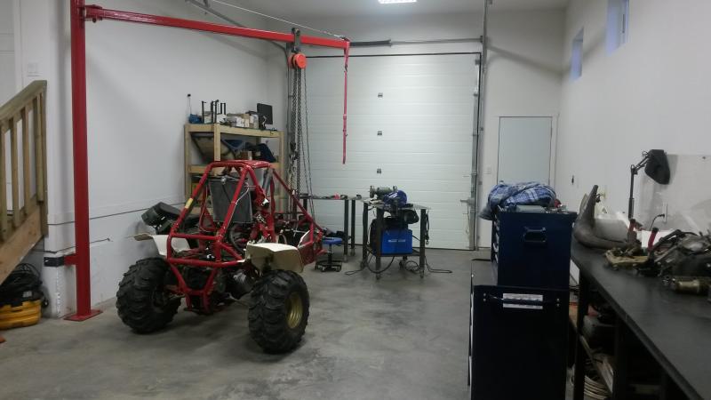

On our last ride of the season my brother crashed the oddzilla #2 hard.
The sad part is this machine was the nice one. All fenders in perfect shape and no rust on frame.
He did a triple flip (one in mid air) and took out the right front corner.
Smashed the front wheel into the frame. The damages were: Bent top J arm mount, bent J arm, bent bottom ball joint, all 4 fender damaged or destroyed, bent exhaust, one shock damaged and leaking. Here are some pictures of the repair. I can't believe how thin the wall is on the pipe. The frame I made with the comealong on it that you see in the pics did not work. I still had to cut the pipes and remove the Honda brace. Looks like I will add some triangle braces as well to help with strength. It is not completed yet, I got all winter.

I did have to cut the top tube and the one coming down from the very top (the small hooked tube).
There was just no way I could pull it. By the way the pulling rig you see didn't work because when I heated the tube the only thing that started to bend was the tube that the rig was bolted to. I ended up hooking the come a long to my truck and the back end of oddy to hoist post.
