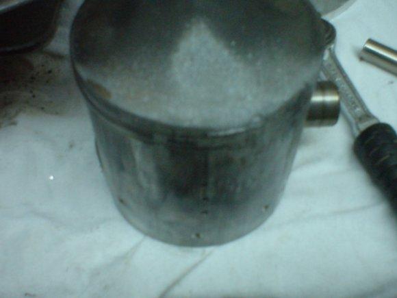

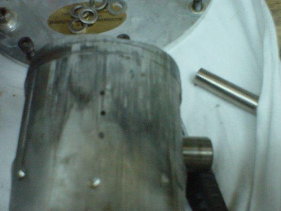

Carb had mucho fuel in the bowls. Randy pre ran it on a stand for 15 min then retorqed everything. Not blaming them just pissed it bit the dust so fast. Got motivated this evening and once the exhaust came off I saw were the top portion of the piston snapped off in the corner. I ran it twice for 15 min idle and then my first run was for about 20 minutes the one day before my nifty radiator hosed me with water and gave me the burns on the other page. It never got hot just crappy fittings. I noticed when I tried to crank it for a buddy of mine yesterday the starter would not turn over. I thought my battery was toast. It would pull start with a great tug though "thought hmm great compression". Well I guess it had already started muffing up. After it stopped on me in the feild the starter suddenly worked great. Like I said it never got over 1000 degress I have my EGT marked and have been watching it very carefully, the plug looks good and oily too. Hell I don't know but this is very frustrating. Heres the pics.

Looked like there was a little hitch were it was ported on the exhaust too. I never heard it detonating or anything. GRRRRRRRRRRRRRRRRRRRRrr. I had them do the works, mild port job, water cooled head, reed spacer and reed kit, crank rebuild, new rod and bearings, leak down and everything. Heck I even paid for the pre run and retorq. I hate it that they had it for a little over two months and then I get stoked about putting it in and finally knowing the motor (( Internal Combustion Engine ? )) was rebuilt and kablewy.

Looks like detonation, ignition or fuel related?
Start reading http://pilotodyssey.com/Fuel-Squish-Detonation.htm

So could it have still been running lean even though the EGT never got up that high. I think I am figuring out the cuase.
