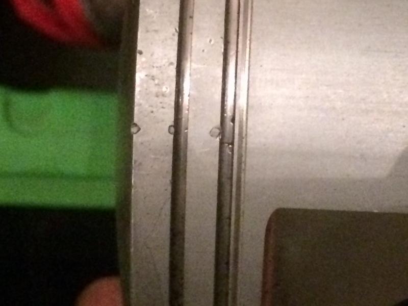

After looking closer at the piston it looks like a rock or small metal is melted into the piston and making the bottom ring stick - ordered all new top end - should have it back together tomorrow and we will see if that was the issue.

PostPosted: Fri Dec 12, 2014 1:06 am
Joined: Tue Dec 02, 2014 5:18 pm
Posts: 20

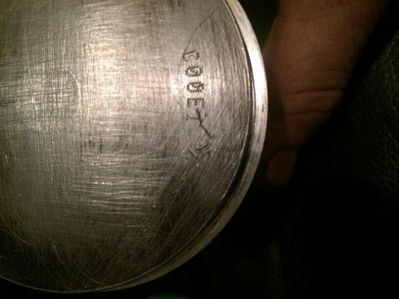

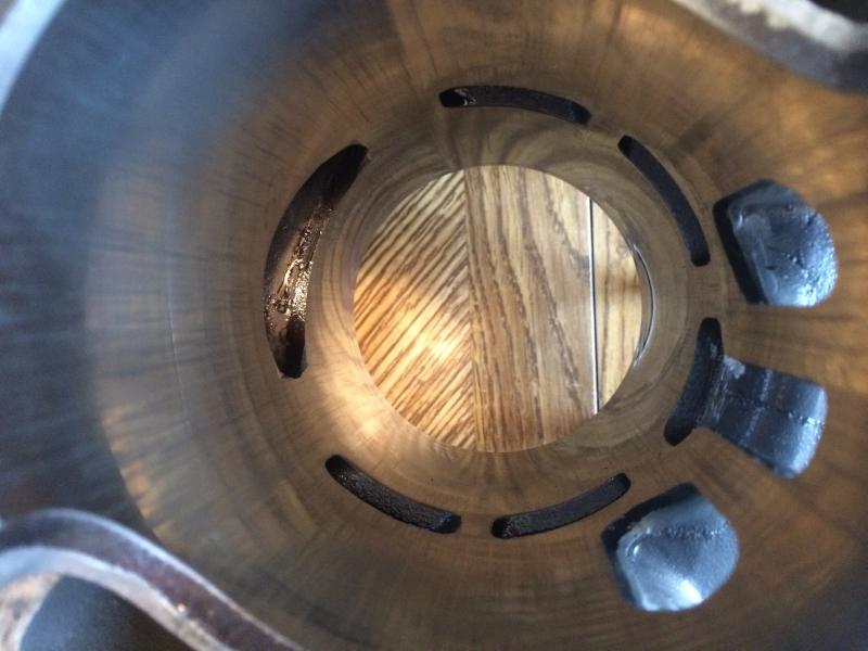

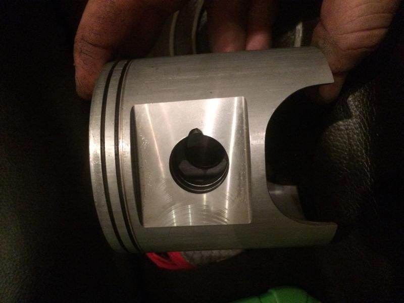

Hoser - thanks for the suggestion. I did a good check of the bottom end and there was no metal in there and the bearning felt good.
Here are a few pics of the piston.
The cyclinder was a bit wavey after a harder look. I am at 82 and my local store said there is noting larger. I put in a new piston and the compression got a bit better from 90 to 125, but that is still too low. I guess its time for a new sleeve or plating - any suggestions?
oh - and yes it still runs like crap
PostPosted: Fri Dec 12, 2014 2:39 pm
Posts: 20

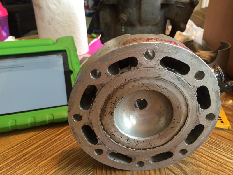

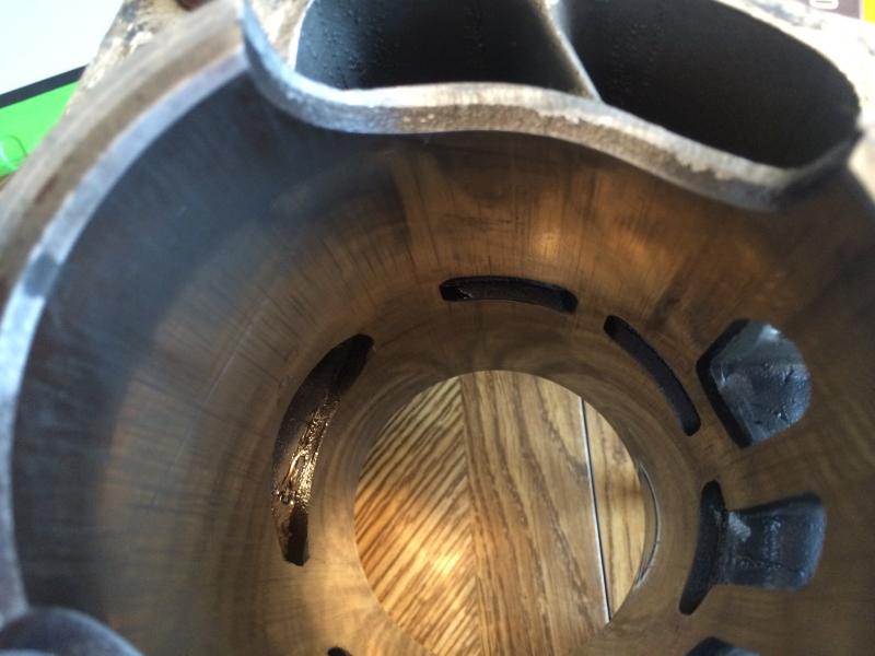

took it all back apart and here are some more pictures.
I really want this to be running for new years at Glamis!!!
Any thoughts

PostPosted: Sun Dec 14, 2014 11:07 pm
Posts: 705
Location: Sacramento
Free bump. Hopefully someone can help.
PostPosted: Mon Dec 15, 2014 3:38 am
Did you check the O-rings in that power head ??
It looks to me like that head will allow you to use different size domes. That means it comes apart and in order to get a seal you need O-rings. Did you check them ??
The reason I ask is because of the way you describe the "smoke" behind the machine. It does seem like water is getting in there.
I have 125psi on my fl350 and it runs like a raped ape. To me 125psi is good enough for now so it should run well but just not have peak HP.
My money says that you have a coolant leak. If the previous owner got the Engine hot he may have cooked those O-rings.

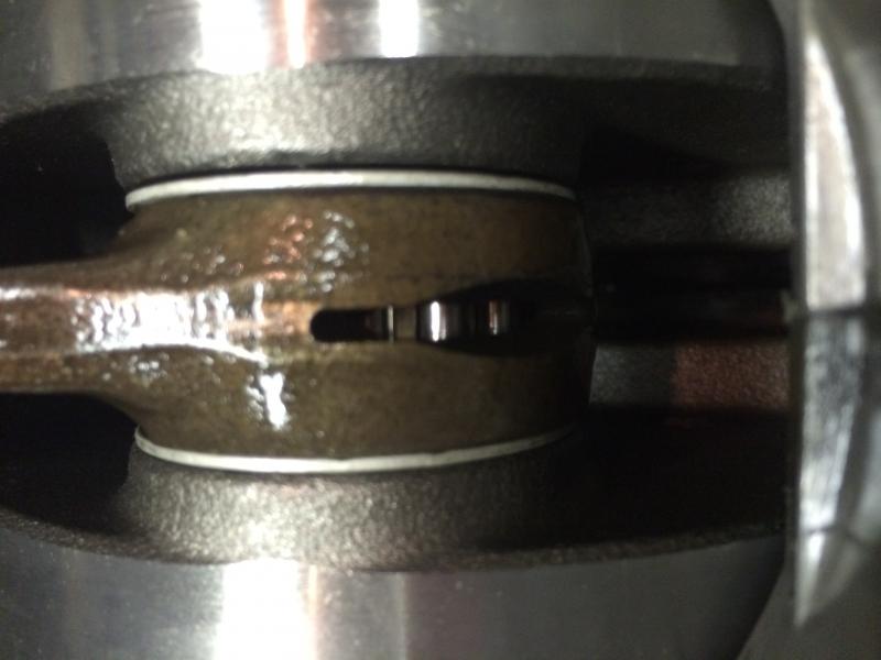

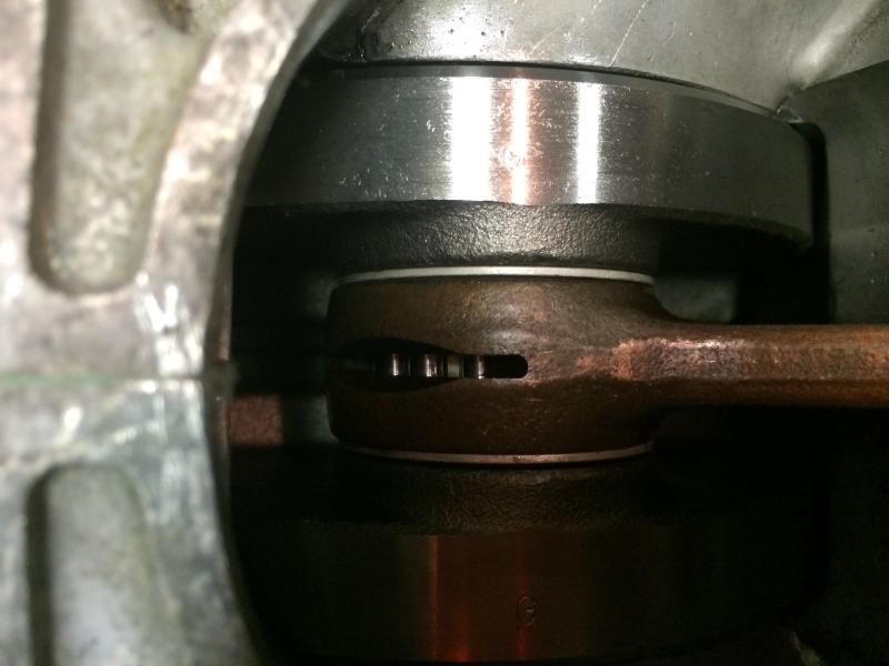

PostPosted: Mon Dec 15, 2014 7:44 am
How about some close up pictures of the lower rod bearing that metal had to come from some place.
PostPosted: Tue Dec 16, 2014 2:00 pm
Posts: 20
here are a few pics
PostPosted: Tue Dec 16, 2014 2:03 pm
Posts: 20
After continuing to look at the head and the bottom end i thing that the prior owner blew up the top end and did not do a good job of cleaning out the bottom end and there were left over particales that toasted the top end again?
