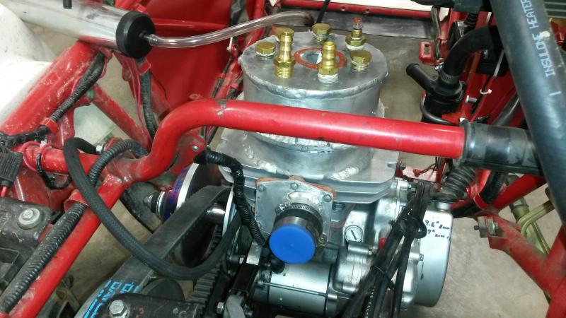

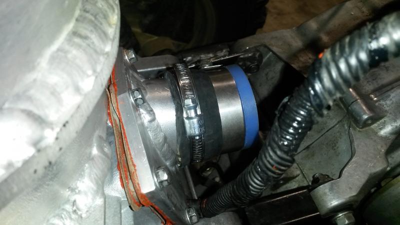

I don't know what kind of welding skills or fabrication skills you have but this is what I did to replace my torn intake manifold.

I made my own as it was the cheapest way to go, but you should go for the Danifold if he starts making them again. DON'T BUY the unit from aftersucks motorsports. It is total crap. You will have to cut the trans brace for it to fit, also it is center mount not off set like the original, also the rubber flange leaked and it won't seal even with silicone because the base which the flange mounts on is to small. Do I need to go any further with this piece of crap ?? How do I know ?? My brother bought one.
It's Danifold or make your own. Amen.
