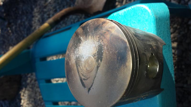

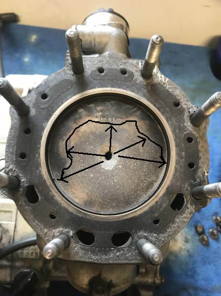

After about 10 hours this is what my Pilot piston looks like. Going to run race gas and see if problem goes away. Never had this problem before. This is Pilot that I thought had low compression but ended up being a bad stator. All four sides look the same

That piston is more than useable.
Buff it up with a flapper wheel and file out the ring grooves with the wife's nail file. Rings look ok to me. Re-install it -- good to go. Then run Avgas (oh god here it comes).
Edit: You did do a pre tear down leak down test right ?? (air leak). At this point I would not spend the money on a new piston because you are unsure what caused it and that piston is good. Just my opinion.

That piston does look like it got real hot to me.
I can't tell by that picture but if those are not scratch marks on the very top (because you may have been looking for a piston number) of that piston then I would say very early sign of detonation.
If those are scratch marks made by you then it could be something else like a lean out condition. Cracked intake ?? Lean main jet ?? Air leak ??
At the end of the day if you are running factory jetting and your Engine had no air leaks then I gota say POO FUEL for sure.

I am not joking when I say re-use that piston and rings.
Your Engine died because of ring lock.
And that is probably why you had low compression to begin with. Ring lock was already beginning.

Did you say that all 4 corners of the piston are scored the same?
If so it's called a 4 corner seizure. Generally caused by getting hard into the throttle before the piston and cylinder have come up to an even temperature. The piston's 4 corners expand too quickly causing them to rub on the cylinder and cause the scoring you see.
Other causes are.....
Too lean carb jetting (main jet), or too hot of a spark plug range.
Look at the eighth picture down in the link below. The picture is a mild case but you'll get the idea.

The piston did get real hot. It was at the beginning of our ride. I saved the old piston. I think those scratch marks are from the shop confirming size.
