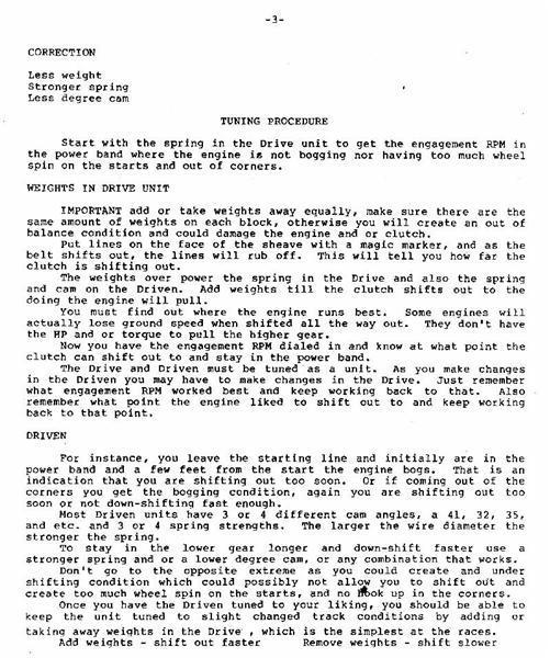

Was going through some papers and found some HRD clutch tuning info.
The first page is kinda rough

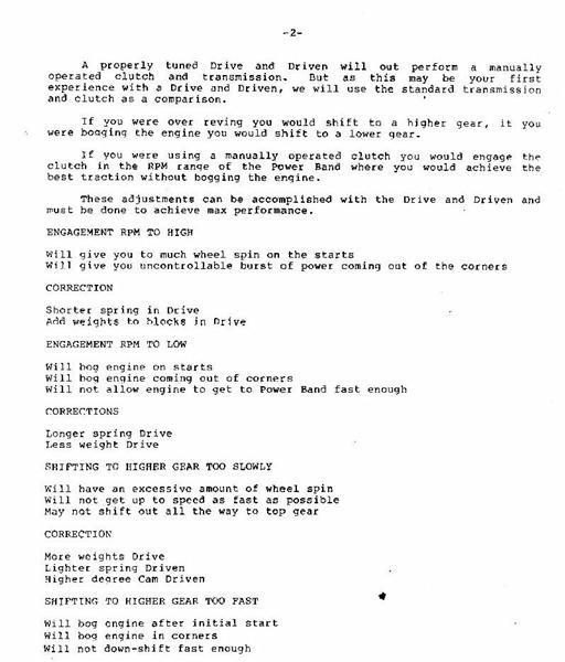

PostPosted: Fri Sep 16, 2005 9:20 am
Page2

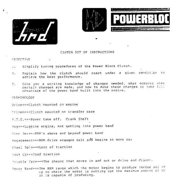

PostPosted: Fri Sep 16, 2005 9:22 am
Page 3

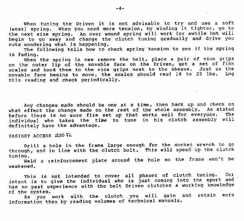

PostPosted: Fri Sep 16, 2005 9:23 am
Page 4

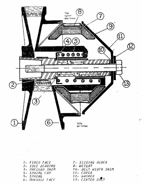

PostPosted: Fri Sep 16, 2005 9:24 am
Here is a diagram on how it works.
I have larger copies of these pics if someone wants to print them out they might make
better prints, email me if you want a set of the larger images I will send them to you.
