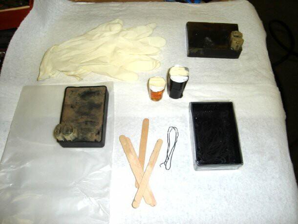

Bill shipped me one of his DIY Pilot CDI (Capacitor Discharge Ignition) mod kits
The kit looks well thought out I will know more when I get a chance to apply it on my
spare stock CDI (Capacitor Discharge Ignition) box.
Here is a link to the DYI CDI (Capacitor Discharge Ignition) mod instructions.
http://pilotodyssey.com/DYI-CDI.htm
No rev CDI (Capacitor Discharge Ignition)
CDI (Capacitor Discharge Ignition) kit

Hi Hoser, did you ever get time to build up one of these? I have not had any feedback on the instructions so far but would appreciate feedback from those that have reviewed them. I want to give these kits out for $20 each including shipping and if anyone needs on built I will do them for $70 including shipping. Also, I will give deeper discounts for anyone that wants multiple units built. When these kits I have in stock right now run out I will probably cease doing them due to lack of interest. I think most folks that need them already have them, or already have enough info from the instructions to get them done on their own. Bill..

I have not done it myself but have the last kit Bill put together with instructions and all you need to do it.
If you want to give it a try = shoot me a PM.
