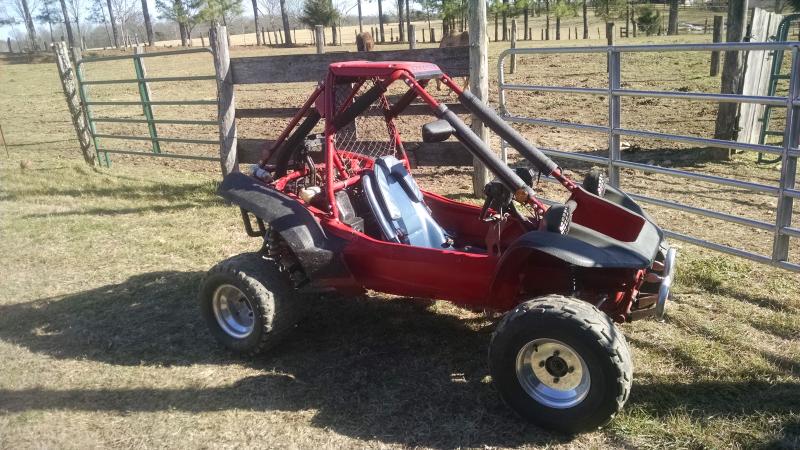

Flushed radiator and cooling system. Had to get balancer oil rinsed out. Rode around farm today no problems. Happy mechanical seal still good. Here's pic of first fl400. Doesn't rev as many rpms as my built 350s though is this normal?
