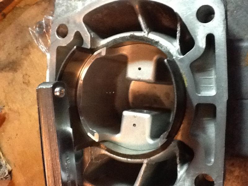

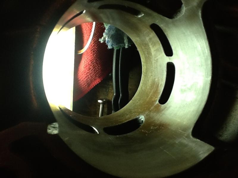

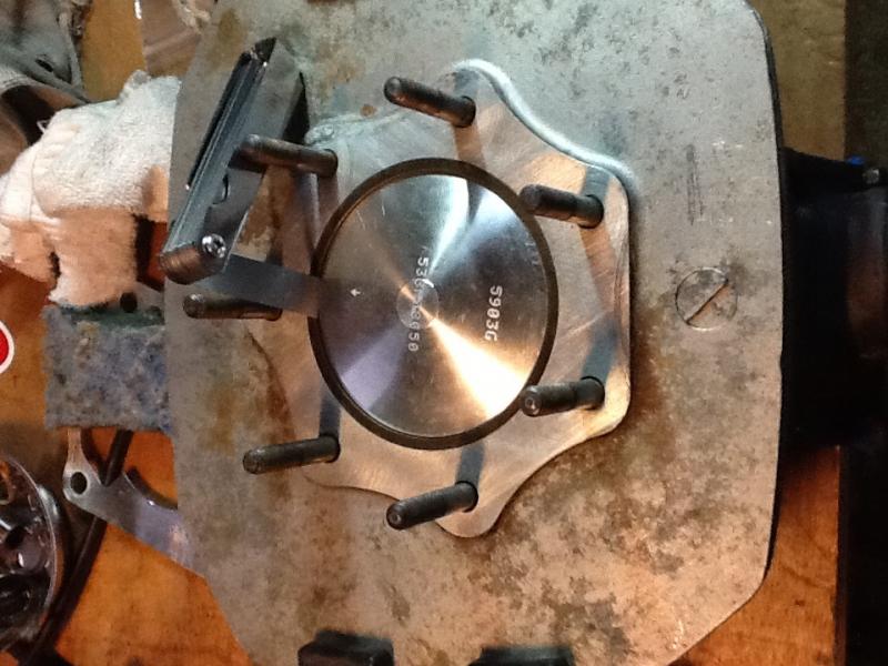

Checked the piston to cylinder clearance again .004 . So we're do I go from here
PostPosted: Sun Mar 06, 2016 7:00 pm
By the looks of your picture, if you can stick the feeler gauge that far down between the piston and cylinder, your gap is bigger than .004".
Without the rings on it, what is the gap at the top of the piston?

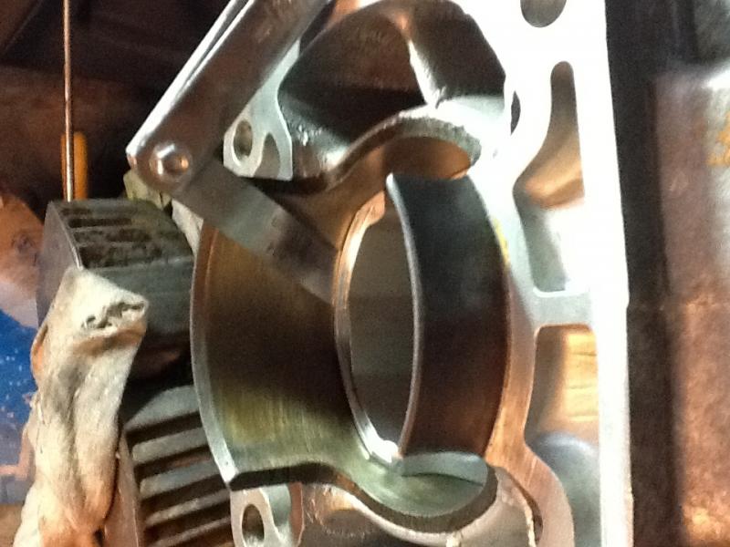

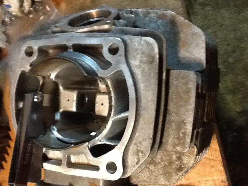

The top clearance is .005 bottom .004
PostPosted: Mon Mar 07, 2016 5:02 pm
Well from the looks of it right now it seems like the bore job is ok.
I actually had one of my cylinders bored at .007 clearance back when I was having Engine issues, and my compression came in at 125lbs with an American made good tester.
So here we have:
1) 90psi confirmed
2) tester good
3) .005 clearance
4) passes vacuum and pressure test so no leaks
So I guess my next three questions are:
1) what is the thickness of your head gasket ??
2) what is the squish ?? The stock Honda squish is excessive.
3) what is the thickness of your base gasket and is it the metal one or the paper one ??
