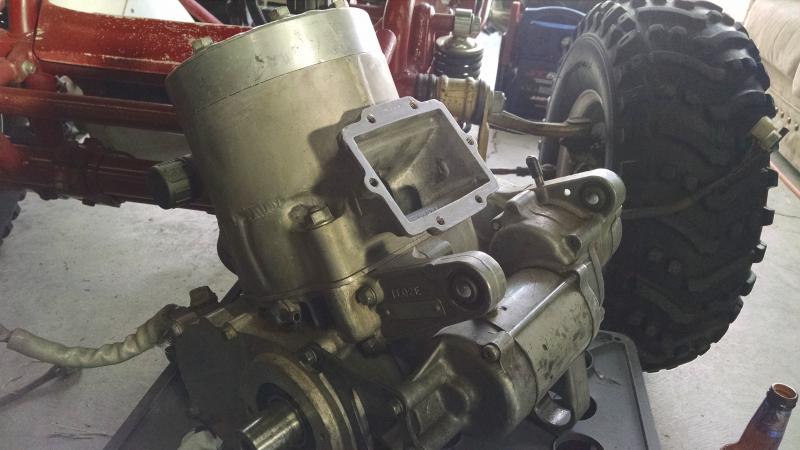

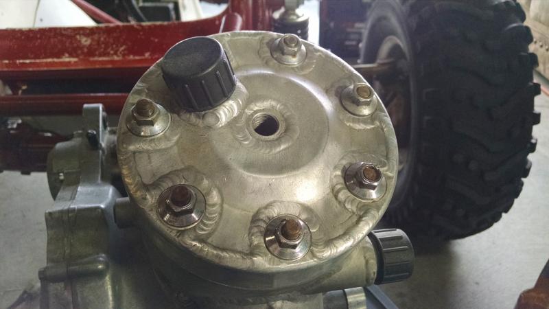

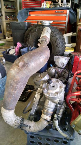

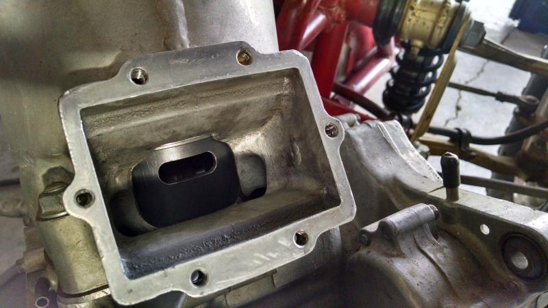

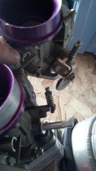

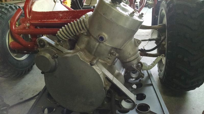

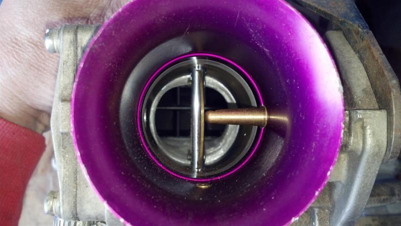

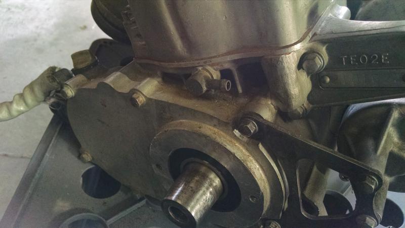

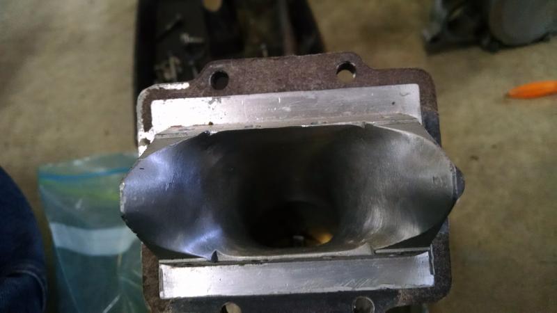

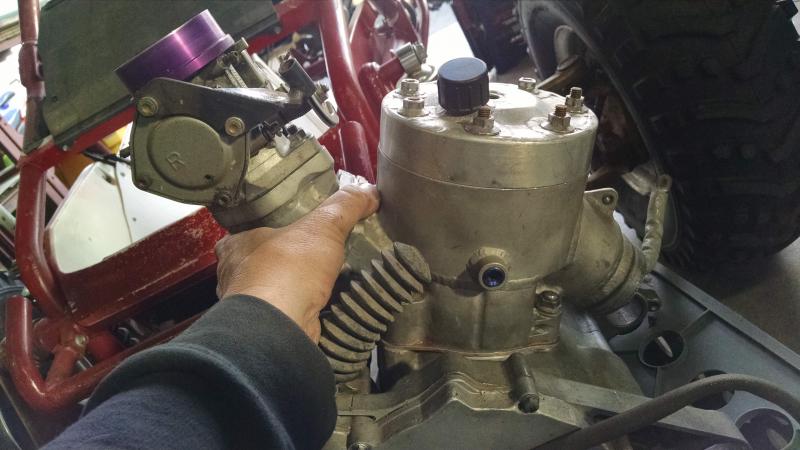

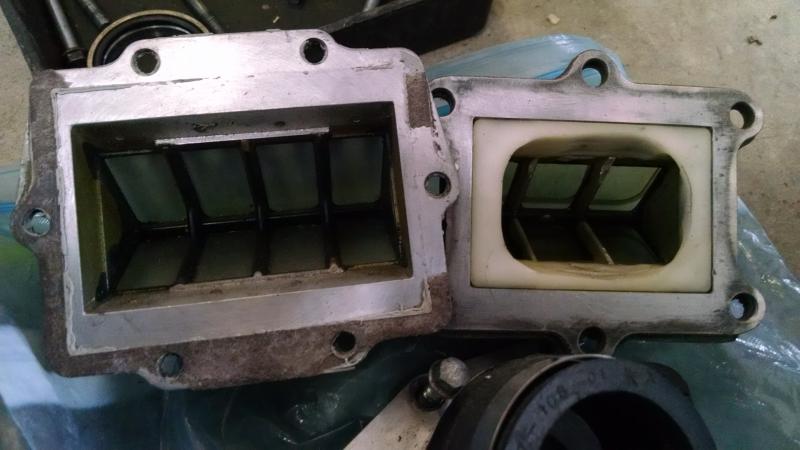

Hi Everyone! Just been crazy busy for a very long time... finally home for a year and lots to do... starting with the first of many big bore Engine installs. This one has the KX500 intake and exhaust graphs, super BN carb, and tuned exhaust. I expect 70+ HP,maybe more...she should flow well! LOL

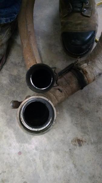

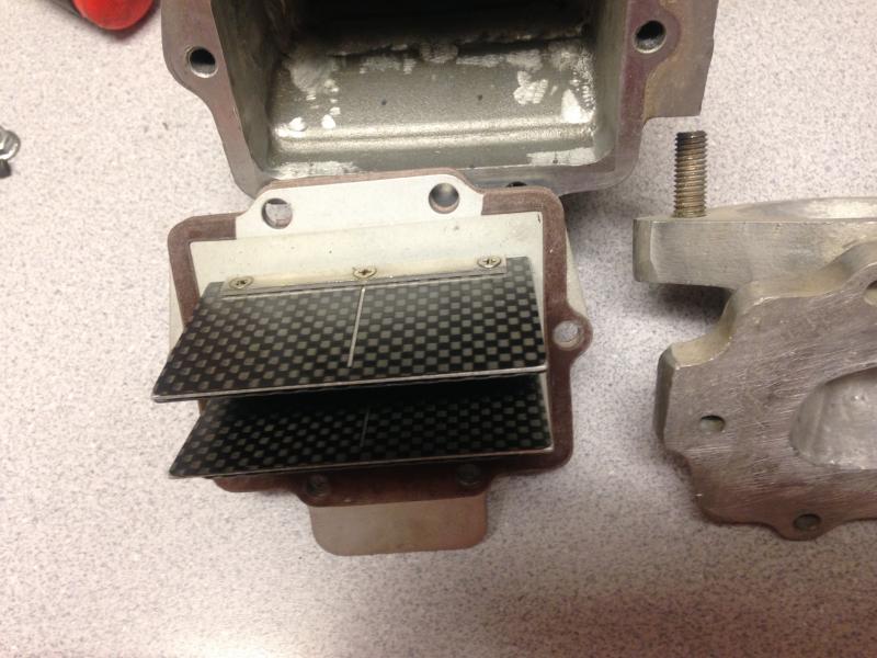

more pics...
File comment: Stock exhaust comparision
File comment: reed cage size comparison

PostPosted: Mon Mar 14, 2016 5:22 pm
:shock: ????????? Does that KX cylinder just bolt up to the fl350 case ??
How much modn is there ??
PostPosted: Tue Mar 15, 2016 11:00 am
Posts: 2243
No,this is one of the stadium racer big bore engines someone else graphed into this custom made liq jug. Lots n lots of mod work went into these engines

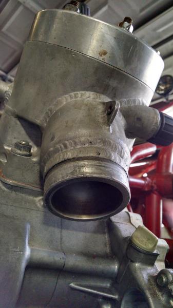

Not to hijack your thread but......

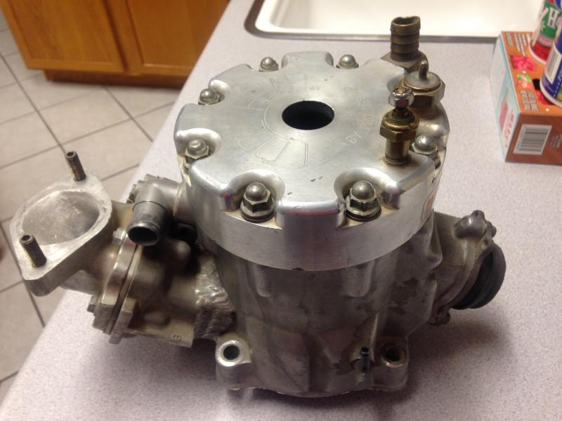

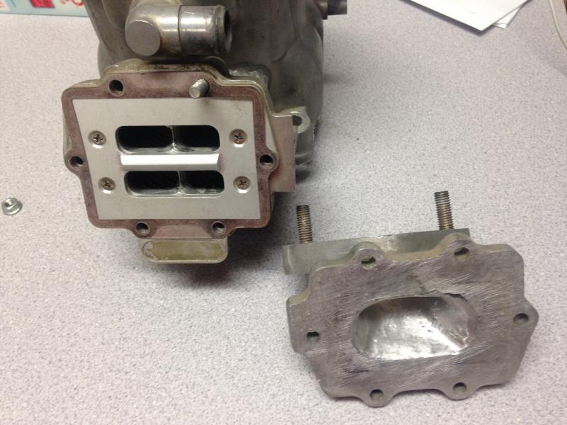

I picked this up, FL400 top end, cool head, with this intake welded to it..
Seen anything like this before?
It is setup for a watercraft carb.
PostPosted: Tue Mar 15, 2016 11:13 pm
Posts: 149
Location: cleveland oh
Interesting. Why the watercraft carb?
Is that a Buckshot carb? 44, 46 or 48mm?

Going by memory that is not a KX cylinder its a Honda cylinder with a Kawisucki intake and exhaust welded on then a new sleeve installed so it can run the KX 500 piston, with the stroke its less than 500cc but revs really well, think Renni said they were about 90HP. This was a very labor intensive design that worked I would make sure not to change a single thing.

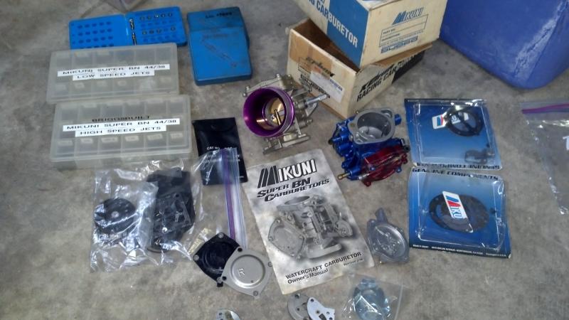

Hoser is right, they are crazy rev engines.They lightened internals, no charging system Bob Briggs stuff was able to turn 10K,or so I was told. Kinda scary! Lots of different designs,but most were 80-95 HP. How have you been H? Doing a 10 year summer of 6s reunion tour??? Would love to ride with ya again.
Thanks Fully, glad to finally be getting back to some normal life stuff...and back to my passion of buggies!!!

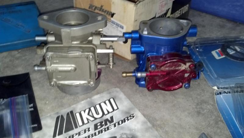

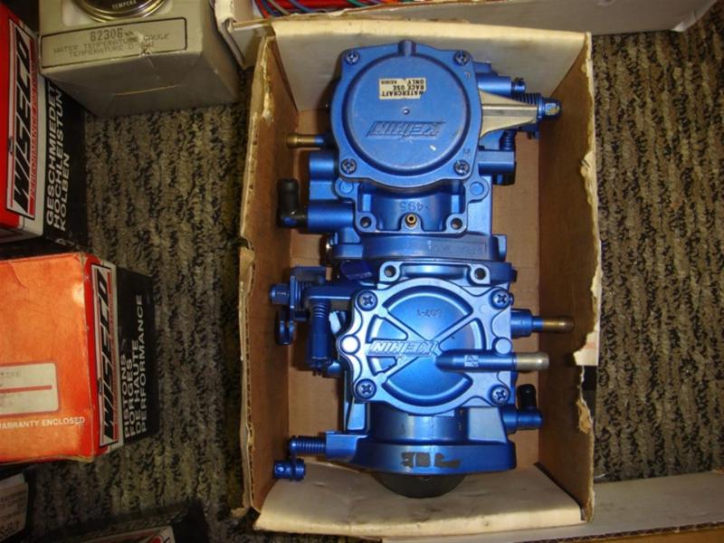

Not hijacking a thing Bob, post away!!! very interesting setup. The dual slot reed stuffer thing reminds me a whole lot of the ESR design. I will find a picture.... The carbs all these guy used is the Mikuni Super BN 44/46mm. I traded the one spare i had to Rusty or may be Chad a few years ago. I have like 5 more but all are on engines so don't wanna give em up. I will post some pics... Also,you still want that HRD pilot clutch?

Can you provide more detailed pics of this setup like the porting and with the head off, maybe start another topic so its easy to find in the future.
