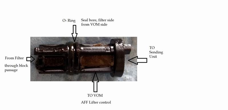

So why did I have an oil pressure issue going to the Valley Oil Manifold. I had to have one or the oil sending unit would not have been telling the gauge to have erratic movement. The oil passage in the block going to the sending unit mounted on the VOM (valley Oil Manifold) came from the filtered side of the oil filter. So do I have a blockage or obstruction. I would have to and answer why the pressure reading were being so erratic. I pulled the VOM and gave it a once over cleaned it and blew of the passages as well as the AFF passages leading from the block to the lifer bores all seamed ok. still did not make since until I removed the oil sending unit to clean this passage. The mother bleeping GM engineers or darn maintenance manual makers. Who new they put a stupid screen type filter in this passage which could become partial blocked from the bottom and only allow a slight by pass under high pressure. This was a bad design or failure to put in a maintenance literature.
All I had to do was clean tis filter and oil pressure at the gauge was restored to 60 pound with only a slight fluctuation when the AFF was engaged allowing the oil manifold valves to allow proper oil flow to the AFF lifters.
Moral to this story you Chevy with AFF has low oil pressure or fluctuates more than 5 pound when in AFF mode clean or replace this filter before lifter failure. Any AFF Chevy over 50,000 miles should have this done or do it yourself. It will take one day of your own time and no parts required if carful. Pull intake remove oil sending unit pull out filter and clean than reinstall. If you tare it get a new one from Chevy there not expensive.
See pic of filter.
