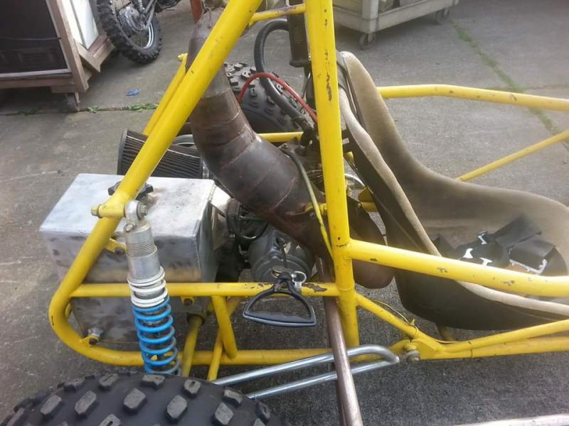

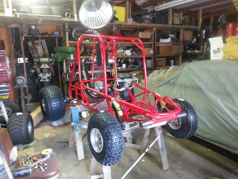

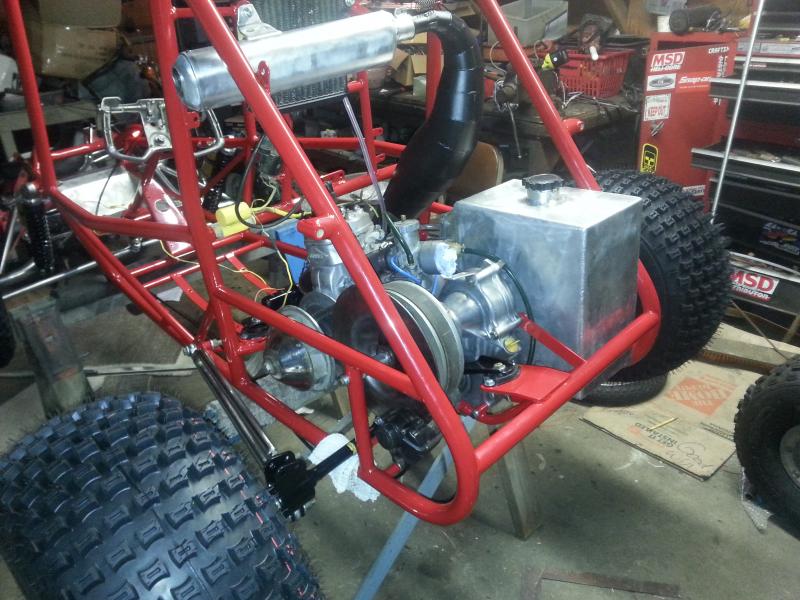

Well Works Performance call me back todsy. My shock bodies both were cracked. Now clueless on what shock to use. Spring rate as well. I need a 15" eye to eye shock. I was thinking about an UTV shock. But wanted to ask here first. The shocks will go on buggy in pics.
Anybody know of any applications I can look at? Works is gonna spec my shocks out and call me back for replacement price. But i bet that's gonna be arm and leg.

in this pic you can see my axle rides about 1/2 above the frame rail. So i can't really go longer that 15". If I used the fl350 shocks and made some bushings maybe I can off center them to close to 15?
Even 15 1/4" is cutting it close. I powder coated to soon.
