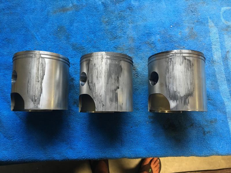

Picture of piston(s). They are shown in order if use.

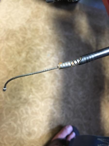

Here's the question: Using a 39mm Keihin - will a throttle cable with the plastic covering worn offof the end where it fits into the top of the carb cap leak enough air in to lean out the Engine? Here's what i started with:
There was a pretty big area around the metal of the cable where the plastic had worn away and the housing that it was fit into with nothing to stop airflow.
Here is the after with a little help from some heat shrink tubing (any better ideas for this are welcome also):
Could really use feedback from anyone on this. The Engine and intake do not leak. What is left but the carb?

Yeah I would say that would be an air leak.
Looking at those pistons it looks to me like there is no sign of detonation so fuel would be good.
It seems to me based on what has happened to all my fl350 pistons that your Engine is hot or the clearance is not enough. Opinions from others ?? Lets vote.

I just keep looking at those pistons. They are all damaged in exactly the same spot and look almost identical. If it was detonation of fuel, the top edge of the piston, usually at the exhaust would be chipped away, but that's not the case here so the fuel is good. The pistons are damaged on one side only -- all of them. They appear to be hot in that area only. Can you check to see if all of the cooling ports in the head and more importantly the cylinder, are all clear and not corroded or plugged ?? Is this the exhaust side of the piston or intake ?? (Never mind it's the exhaust. Just figured it out).
You said: Extensive rebuild and (almost complete) restoration that ran great for two months. Then it melted the rings out of the blue.
So what did you change if anything before it blew up ?? That carb cable was probably the same in the two months prior. If you changed nothing then something changed over time. Coolant flow ?? I am really grabbing at straws right now.

Cable on carb won't cause an air leak. When you do a leak down test, you're testing the cylinder and bottom end for air leaks. Looks like your clearance is still too small and that's why the pistons are melting. Any time you have the cylinder bored or honed, you need to check clearances. Measure both the piston and cylinder or have the shop your taking it to show you what the measurements are. Use the clearances recommended by weisco, not the pilot service manual.
A few more things when doing a leak down test.
Take off carb and plug intake side with a rubber plug
Take off exhaust and plug opening on the cylinder again with a rubber plug
Take off hose from pulse and plug the pulse on the cylinder

Pilot Bird is correct, although the cable is not sealed and will let a small amount of air in, the hazard here is more along the lines of wearing out the slide in the carb because of dirt getting into the top of the carb and not leaning out the Engine.
What do the other sides of the pistons look like?
Are you sufficiently letting the Engine warm up before you hit the throttle? The piston itself needs to come up to temperature and expand properly. This is a big issue with a belt drive system like the Pilots and the Ody's have. You can't baby the throttle and gust put around until the Engine warms up. Remember, the clutches don't even engage until the rpm's hit around 3000. You must let it warm up properly!
And again as Pilot Bird mentioned.... what are your piston to cylinder clearances?

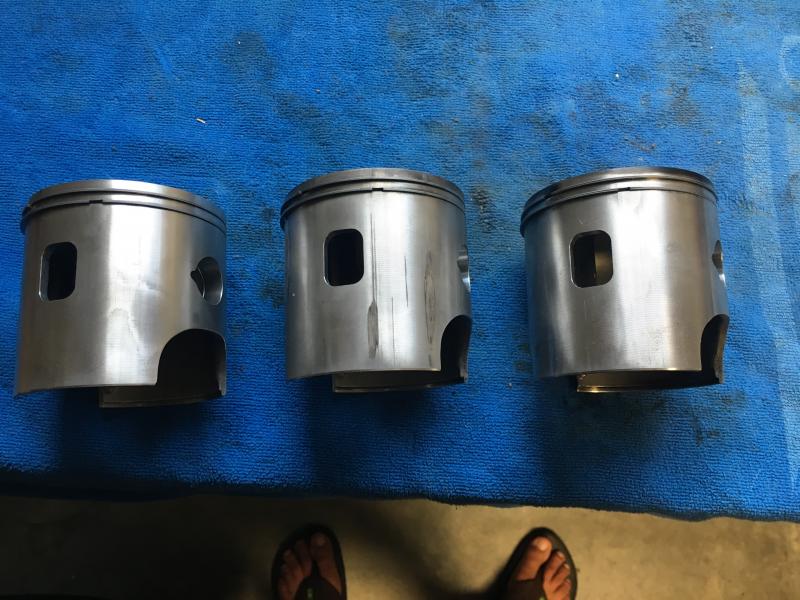

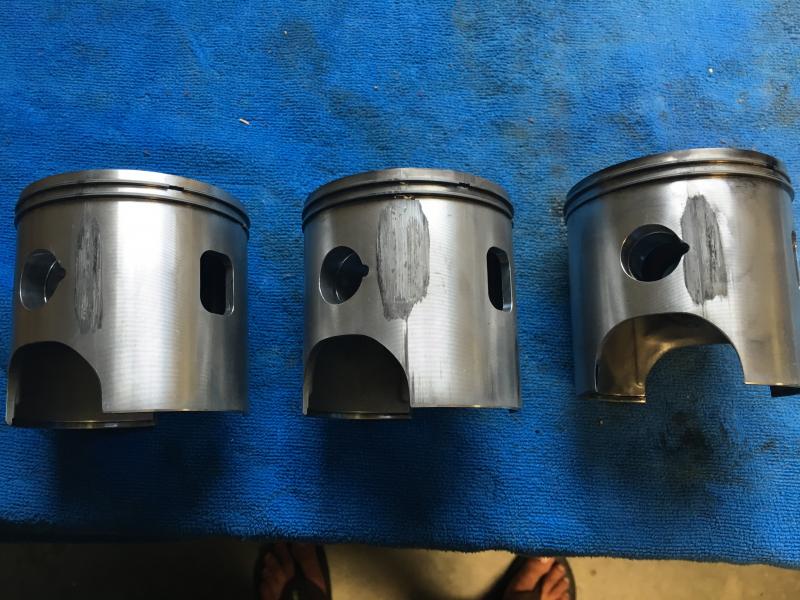

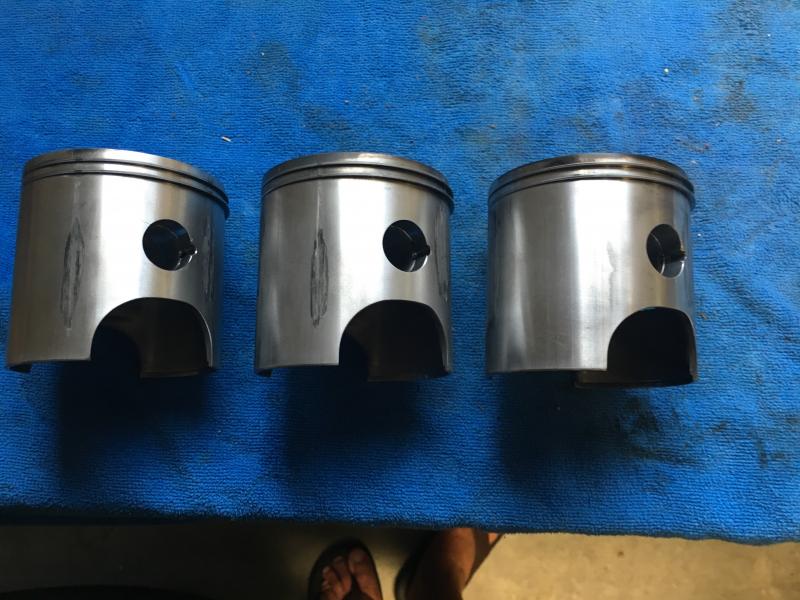

Here are all four sides of pistons placed in order of their demise, from one to three.

Well seeing all sides of the piston now my money says your clearance is just not enough OR your not getting proper cooling. No damn way can a piston be scared all around like that without clearance issues in my honest opinion. The intake side is the cool side by far, yet it is scared up. That just screams clearance to me, not air leak.
PostPosted: Thu Sep 01, 2016 2:45 am
Was there any hone work done on the cylinders between pistons? If so, what type of hone was being used? Were the hone marks uniform all the way around the cylinder?
Normally on jetting issues, the exhaust side of the piston is melted and scored but you are getting scoring on the sides. This is pointing to a cylinder that is out of round or possibly a 4 corner seizure.
Are the score marks on exact opposite sides of the piston? If they are, check your bore diameter on the area of the cylinder where the scoring is occurring versus the aide that has no scoring. My bet is there is a difference in the measurement which means your cylinder is out of round.

Take the carb off but leave the cable attached. Block the air filter side. Take a plastic soda bottle and cut the bottom off. Tape the cut end to to the intake side of the carb.
Now see just how much air is passing you're cable with and without you're shrink tubing fix buy pulling air through the soda bottle top. ( I avoided telling u to suck on it )
You could go one step further and take a empty soda bottle and make a hole in it and see how big u need to make the hole to match how the carb feels.
I'm not saying this is the only issue but may be contributing to it. If hardly any air passes I would think it not an issue. However a bunch of air I would consider it a contributing factor.
