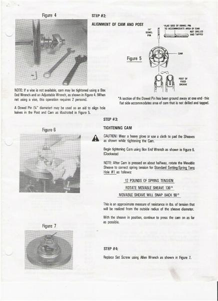

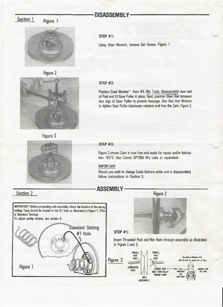

Hi Curtis, finally got around to scanning the Comet 90D Instructions for you:

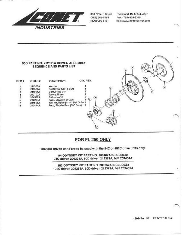

I found a little more info, and a few pics also:

I hate to raise an old topic, but this is the information i'm looking for. I can't read any of it. Does anyone have the full size images that they can send me?
PostPosted: Thu Sep 29, 2016 9:44 am
Zoom in - Hold down the Ctrl key and scroll the roller on your mouse. Assuming you are viewing on a Windows PC.
PostPosted: Thu Sep 29, 2016 11:52 am
Joined: Tue May 05, 2015 4:37 pm
Posts: 81
Location: Philadelphia, PA
So, just tried on the PC, and same as my phone and tablet, i can see words there, but they just get blurry when i zoom in to see the details. I do use glasses, but to see far away, so i know that is not the problem.

Yeah, did the google searches, tried a bunch of keywords, and the best post was this one. Was hoping one of the members took up the original offer for the full scans. I think I put mine back together using what few words I could make out. The previous owner of my 90d had the spring in hole 2, and it just wasn't shifting where I wanted it to. Will have to test it when it stops raining I guess. Would still like to get the original to put with my books if anyone can get a scan of the full documents.

There isn't much info on the 90d out there, a lot on the 94c, but not much on the 90d. I didn't even know that there was a built in adjustment until later I came across a post saying to put the spring in another hole. Started diggin, looked at the clutch, and sure enough found some holes in it. Found this post, which looked perfect for a starting place, but found the words and finer details to be a bit hard to read when you enlarge it. I'll have to see if the people in hosers link can send me a pdf or copy.

Well, success! I have to thank Joe from Oddatv for sending me a pdf copy.
Trying to post a link from my Google drive:
https://drive.google.com/file/d/0BzbSkJ ... p=drivesdk
