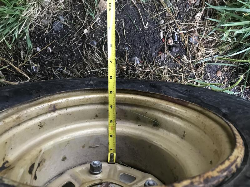

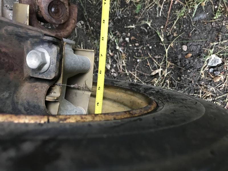

So I bent a rear wheel yesterday and need to shop for another. Of course as I am new to odys I am learning all kinds of stuff mechanically speaking. So I believe I have an original set of wheels on 350, and appears my off set on rear wheel is balanaced at 5" front/back from mounting plate (or hub)? Does this sound right? If so I do I neeed to look for a rim that is 10" with 5" centered mount or something off centered that is after market?

I am not positive what the OEM rim size is. I believe that the best option would be to find another OEM rim if you do not plan on replacing both rear rims. If you choose to replace both, most people use a rim size:
10X8 3.0 + 5.0

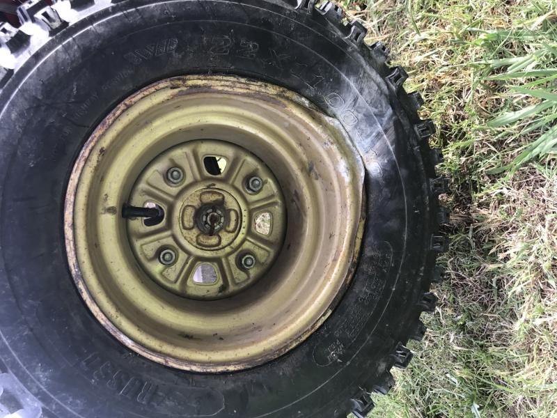

The rim in white spot got knocked in about 3/4" and you can see changed wheel shape to tear drop almost. I do not have any tools to fix repairs like this. At home I barely have one toolbox with mix and match pieces!

If that's the only damage to that rim then it is easily repairable with a torch and hammer. You got any welder buddies that hang out with you ?? One of them will have a torch.
