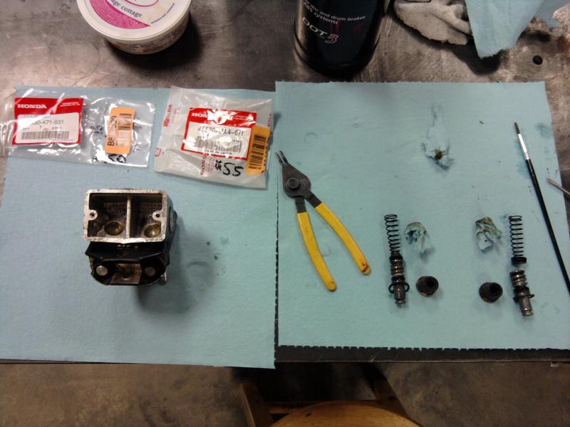

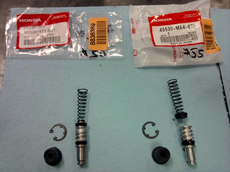

File comment: Here are the part numbers of the kits you need for master cylinder. Still available from Honda

In section 12-9 in the manual it shows a picture. These are very basic units. Just remove the snap ring and pull out the bits you see in the picture. Then clean it all up nice and install the new parts with lube. Lay out a nice clean white rag and lay stuff out in order as you take it apart. Put it back together the same way. Not rocket science. Once it is all back together you will have to bleed the air out of the system. This can be a real pain in the azz on an FL350. The master cylinders don't move much fluid so it becomes a chore to bleed the system. Everyone has problems so you won't be alone. Always make sure you can get maximum stroke on the levers as this will help. Everything (including the manual adjustment on each wheel) must be adjusted according to the book to get max stroke.

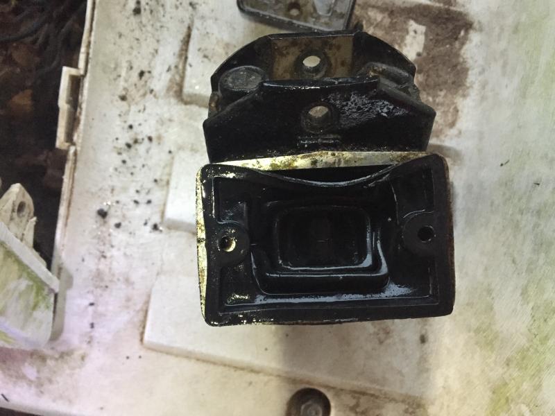

Do I need another one of these rubber gaskets as this one will not sit flat.

I don't know exactly how to take the rubber boot off the master cyclinder. Can you tell me how it comes off and how it stays in place after replaced?

That boot should just peel off easy. Then reform the rubber with your fingers. It is very flexible rubber. When you put it together it just sits in place and you put the metal cap on very carefully so you don't disturb the rubber out of place. Without this rubber boot the fluid will leak out. I azzuming you are talking about the picture above.

4) Do I need another one of these rubber gaskets as this one will not sit flat
The rubber is very flexible and you should be able to reform it with your fingers. Without this gasket it will leak brake fluid.
PostPosted: Wed Apr 05, 2017 4:04 pm
If you really have to you can probably make a new gasket out of a piece of inner tube. Then poke a very small hole in the center so the system can breath. I find it hard to believe that the original is shot. This area don't see much action so how would it get damaged ??
Also looking at the picture I see a lot of poo around one of the small rubber caps on the end of the pistons. Is that poo or was this thing in a fire and it melted the rubber cap ??
