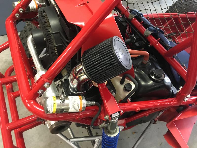

By modified, I am referring more to carb (39mm Keihin), pipe/silencer (Paul Turner pipe and stock silencer) and airbox (see pic below) mods and not so much porting. I have spoken to a few people (both on the forum and locally) that after hearing about the issues i have experienced and shown here
viewtopic.php?f=1&t=16807
viewtopic.php?f=1&t=16945
viewtopic.php?f=1&t=17367
strongly recommended I do not run standard pump gas and stated that more than likely, this is at the root of my issues. Still working through the piston problems and wanted to get a feel for what everyone is using out there to either help confirm or eliminate this as the source of my problem. It has been going on too long.
Pic of air box lid - 3" intake and automotive cold air elbow. Silencer shown has been replaced with stock:
Thanks in advance.
