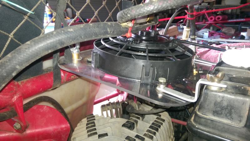

Make your own fan set up
in Oz the temps can be 35 to 40 in aussie lingo or in your temps 95 to 104
and Yes it makes a noticeable difference.
Mine is switchable. in summer it is on all the time.
I am head away for a weeks buggy riding in a months time Middle of winter
here and will still switch on the fan in the tighter slower stuff.
Here is a link to the same fan in Oz but you do a search in the US for the same
http://www.ebay.com.au/itm/8-Inch-Radia ... 3a7d3a702f
bit of 5mm perspex cut a hole and bolt it on and your done

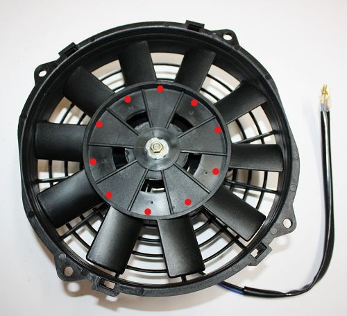

BUT """"""""""""""" READ THIS """"""""""""""""
MAKE sure YOU take the fan blade off and drill holes If there are none
See Pic of fan SEE RED DOTS Drill 1/4" holes evenly this will let the water escape.
Because when you wash it down water will sit and trash fan m0t0r.
wyeeoddy

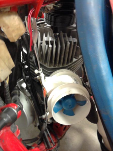

You can also go with a setup like this.....
This was the setup I made for my old Ody before I went water cooled. This way it hits both the cylinder and the head.
