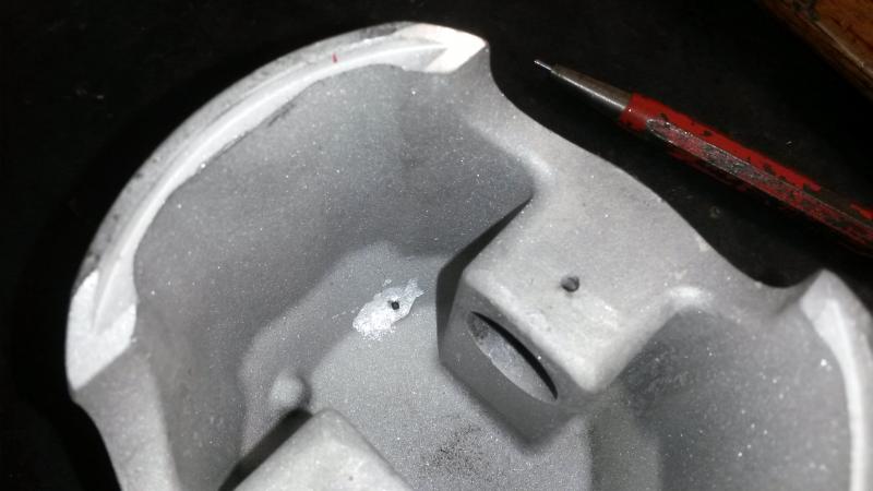

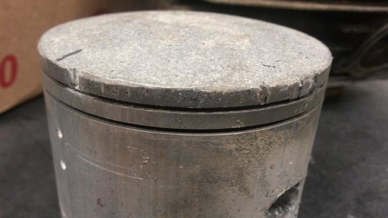

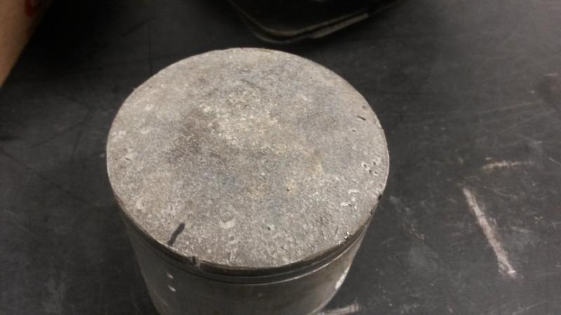

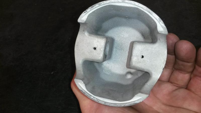

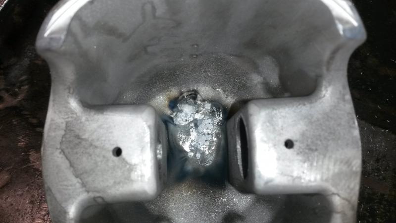

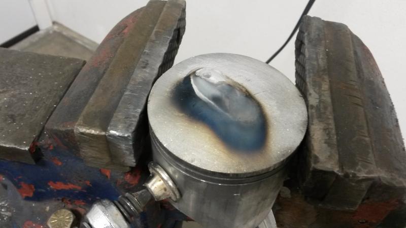

Piston welding anyone ??
Damn I wish the ring lands weren't damaged on this piston because I would install it.

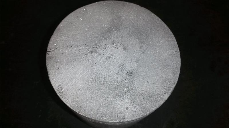

Since I am going to end the piston molding thread, I think I will resurrect this one.
As soon as I figure out what bore that other cylinder is on, maybe I have a piston here that I can weld up and install.
Stay tuned :-) .
 Post subject: Re: Piston welding

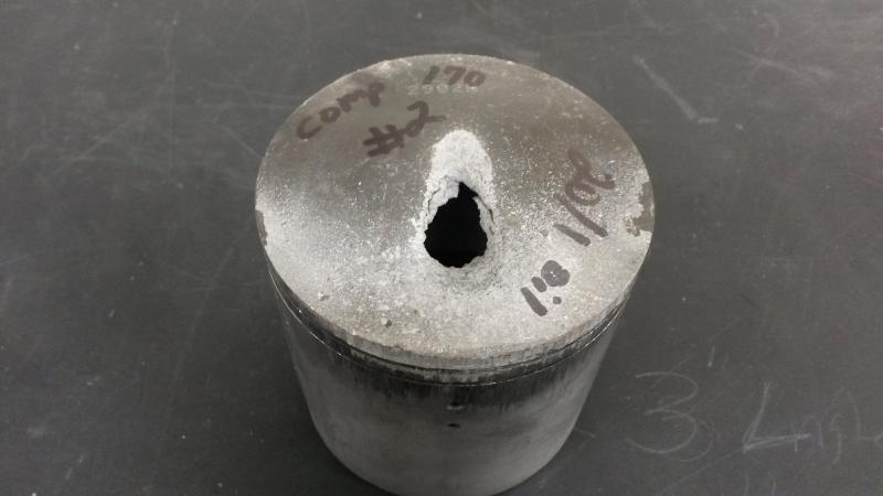

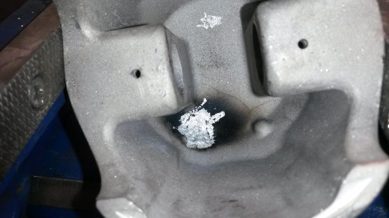

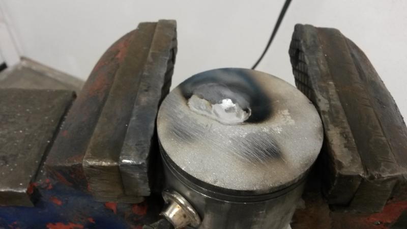

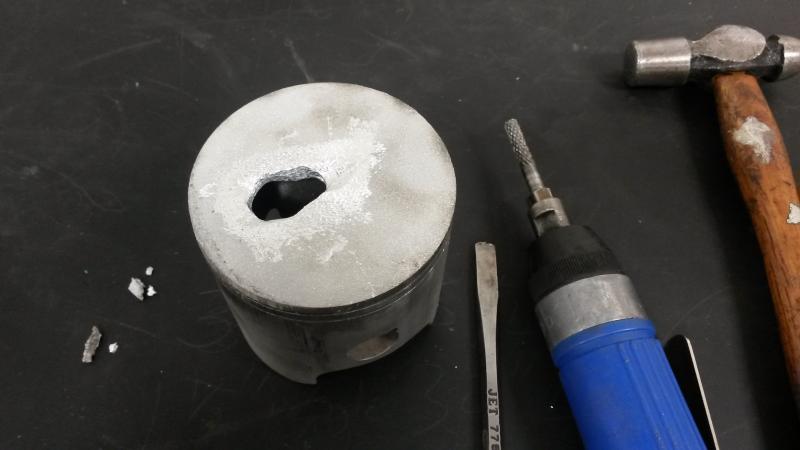

PostPosted: Tue Oct 16, 2018 5:25 pm
Just received a cylinder from CurtisR401 -- awesome.
It's on it's last bore 82mm and I got a blown piston to weld up. This piston is from the Engine that blew the connecting rod bearing when my stock intake developed a crack and leaned out the Engine. The bad part is this piston has no hole in it. The good part is that the top ring land is damaged and the top of the piston has shrapnel imbedded in it and some divets from the bearing rollers.
Not sure yet but I think I might drill a hole in the top of it so I can re-weld it.
This will be a fun winter project.
PostPosted: Tue Oct 16, 2018 5:53 pm
Should I drill a hole in it and weld up ??

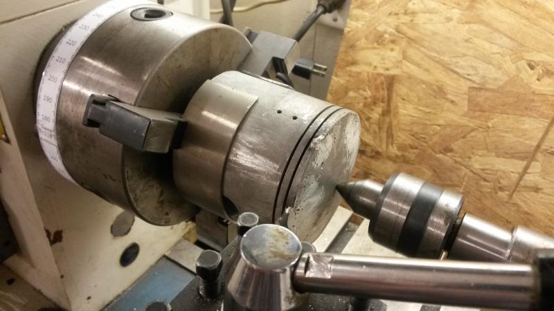

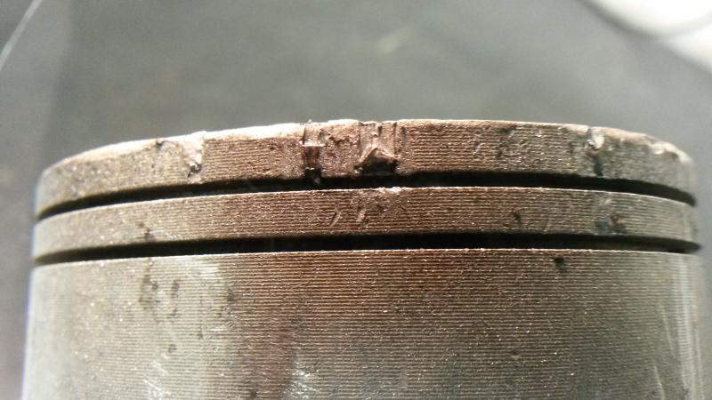

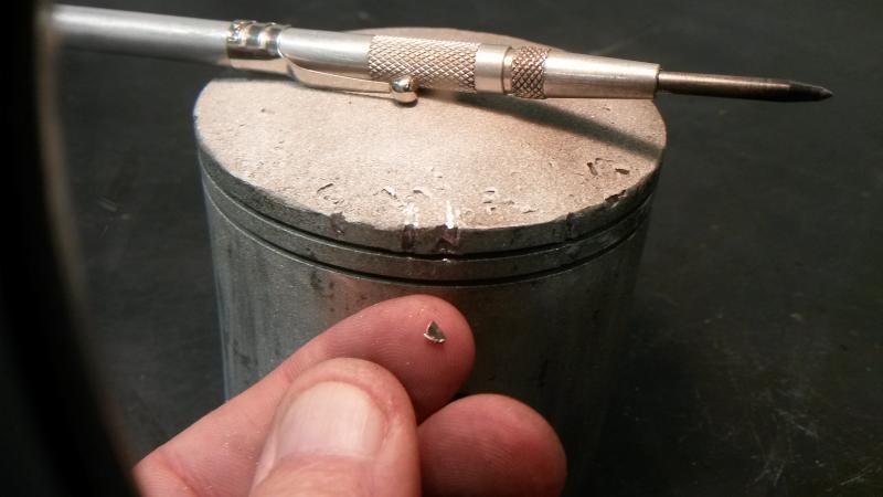

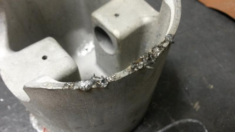

Well I spent a bit of time on this tonight.
The pics below will tell the story.
You will notice that the piston still had some of the rod bearing pieces embedded into it.
They are magnetic so if you run a magnet around you can tell what is metal and what is just a divet.
These pieces come out real easy with one of those automatic center punches. Usually on the second punch.
Then I ground the back end of the ring stop pin (inside the piston), and punched this pin back just far enough to be below the ring land. The reason is that I will be pushing it back into position once I have welded and re-cut the ring land with a lathe tool that will be specially ground for this job.

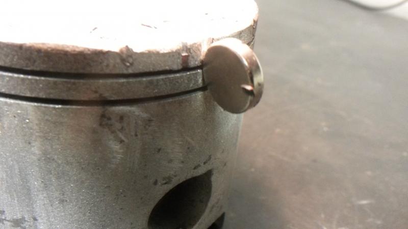

Next I measured the ring groove size with a feeler gauge.
It's .047 wide.

Before welding I took some piston measurements for later use because I will have to turn it down in the lathe. Measurements were taken by my highest quality Chinese mic's, in line with the piston skirts. It appears that there is a .020" taper from top to bottom on an 82mm wiseco piston. Also of important note here is that there is an .008" difference (almost half of the total) between the measurement at the bottom of the bottom ring groove to the top of the piston. I don't really know how accurate that is because this piston was damaged but I tried to find a clean spot. I think it is close though. This would make sense to me because it gets real hot at the crown of the piston compared to the bottom of the bottom ring, and even less at the skirts because these areas get cooled a bit by the incoming charge.
I also took a measurement opposite of the wrist pin to see if the pistons are oval. I got a .002" difference but I really don't trust that measurement with my equipment. If they are oval then it's not much and there is no way I could do that in my lathe anyways. I will only have to dress up the top part of the piston anyways and re-cut the ring groove if this is successful.
Really looking foreword to this project.

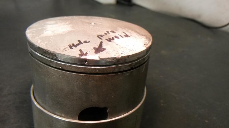

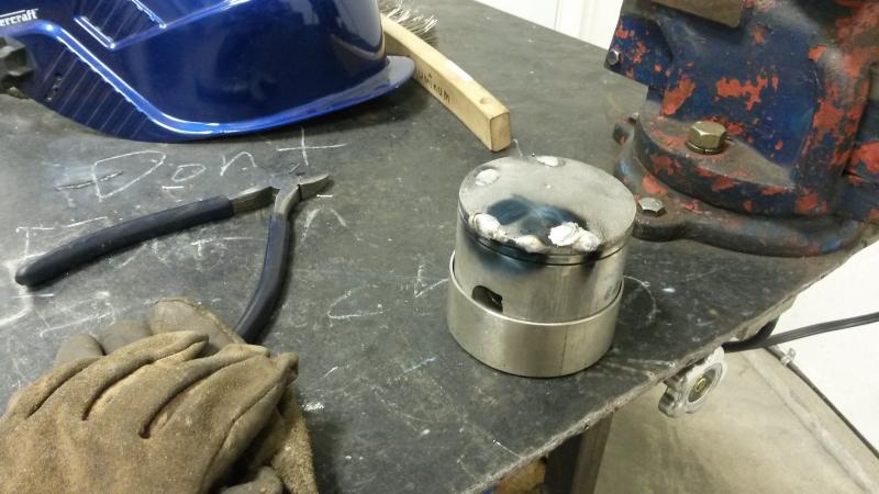

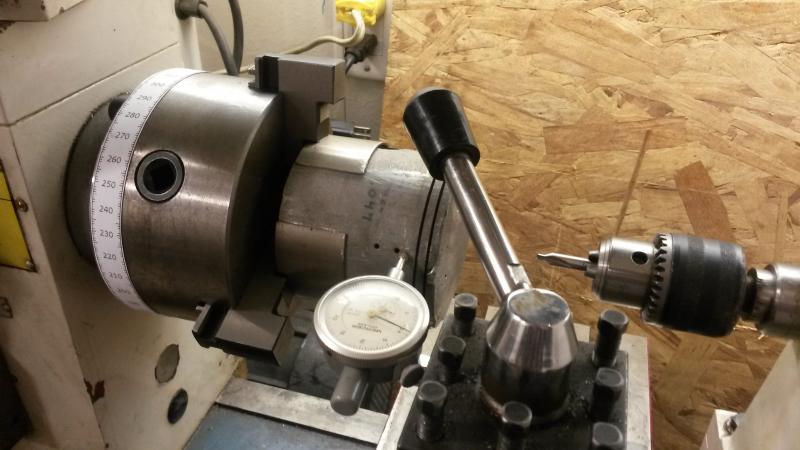

PostPosted: Wed Oct 24, 2018 2:34 am
Project is coming along nicely as time permits.
Today I welded up the piston, made a cutter for the ring groove, cleaned up the piston.
As you can see it don't work out on the first try and requires possibly a few tries. There is not enough weld on the edge on one spot and also a small porosity hole. Also I tried to use a piece of copper in the ring groove to try to save me some work. That didn't work out very well. The copper and the aluminum weld just adhered to each other. Don't do it. Other than that it seems fine.
You will also notice that I had to make a ring for the base of the piston so that you can hold it in the lathe. A piston only has two skirts but a lathe has three jaws so this ring is required.
Also you will note that the dummy that was welding did not have a good ground when he was welding on the top of the piston. This caused the skirt to arc out on the table -- IDIOT -- the worst part is I know better.
File comment: IDIOT welder didn't have a proper ground
File comment: Welded up the piston but used copper in the ring groove to try to save work -- don't do it
File comment: Made a cutter for the ring groove
File comment: Dial in the piston so it rolls straight
File comment: When re-cutting the ring groove I didn't use machine power. I just turned it by hand and cut the groove
File comment: Results -- will have to redo it again

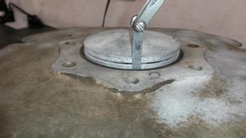

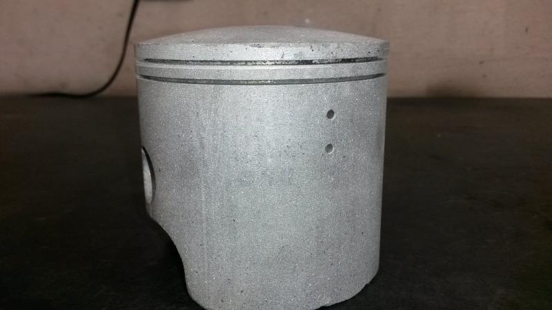

PostPosted: Thu Oct 25, 2018 1:48 am
Here are the results of the re-weld job.
I had to do all of the above again because of a couple of flaws. It wasn't a surprise that I would have to do the lathe work two or maybe three times. Looks like twice was good.
In the pics below you will see that I re-welded the flaws, recut in the lathe, set the ring stop pin in place, welded the back side and grind out the excess, sand blast to look for more flaws. Also tried the piston in the cylinder and feeler gauged it. You will notice that since the pistons are tapered I got a .017" in at the rings and a .005" at the skirt. So when you measure pistons, it's at the skirt.
I am satisfied with the outcome of this project. At this point I think this is the end of this thread until I install it in the Engine I am currently building. I will update this thread next year at riding season. The Engine with this piston will be installed in the death machine.
There are many reasons why I did this. One of them is that if this is successful it would prove that you never need to buy another piston again unless it is worn down out of spec. If you blow a hole in it or lose a rod end bearing and smash up the piston, you can just re-weld it. That's the theory anyway.
Currently getting ready to liquid cool that cylinder that CurtisR401 sent me and stripping a spare bottom end Engine I had on the shelf. Then building a liquid cooled head from scratch. All of this stuff will be bolted together and run next year. I will start new threads for this stuff and not contaminate this one.
File comment: Re-weld the flaws and repair in the lathe.
File comment: Reset the ring stop pin, re-weld back side and grind off excess.
File comment: Final result
PostPosted: Thu Oct 25, 2018 1:52 am
Feeler gauge pics.
THE END
File comment: .017" at ring area
File comment: .005" at the skirt area
