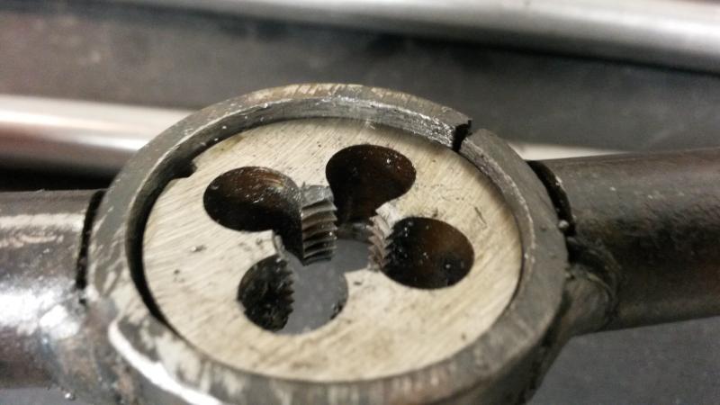

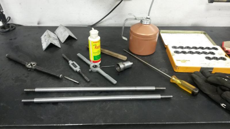

A while back I bought a left hand die on Amazon so that I could make my own steering rods for the oddy. The die came from China. Unfortunately for me it would not cut. I could run it over an existing rod to chase the threads so I knew it was a correct left hand die, however it would not cut new threads. So last night I decided to modify the die. I got out the dremel tool and had to re-shape the top thread. It worked well. Sad -- they can't even make a FN die nut, unbelievable. Anyways it worked out and I made a couple of new rods using some 9/16" cold roll. Turned down the ends in my lathe to .390 and made two rods. Gota make two more for my machine. I did make them slightly longer than stock because there really isn't that much engagement in the rod ends on the stock rods and I wanted more.
Edit: yes I did F up the first rod when I did not start the RH die nut square. Threads are suspect. Will have to make another one.

is it a common thread, or does honda use a off thread..just thinking for ball joints might be easier to get a common thread ball joint if your making your own. i cheaped out and just bought left hand nuts and welded them on
Honda steering rods are 10mm x 1.25 pitch.
There are several ways to do this but I just decided to make some from scratch.
You could get a left hand threaded metric bolt and weld it on a rod but I think that is dangerous if it snaps off. You could "Hoserize" your stock rods. You could swag a tube and tap it and use a long threaded bolt and cut the head off. The easiest is the way in my opinion is to make them from scratch IF you have the tooling.

looks good
But I would not have gone with a square cut where you have stepped it down
I would of tapered it as that has become a weak spot.
But then again was that the plan ??

looks good
I agree with you here but I could put them back in the lathe and taper it back. It's just a pain in the arse setting it up to cut the taper.
