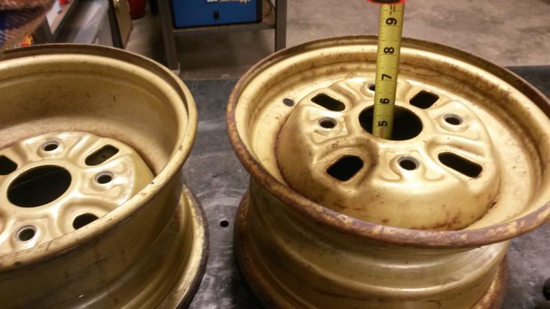

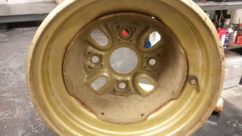

Well I was out in the shop for a couple of hours and decided to take apart a stock front rim to see how much offset you could get by flipping the center hub around.
In the pics you can see that I did not drill through with the half inch bit. Just drill deep enough until you can see the rust ring appear. Then smack out the center and flip it around.
Originally the stock measurement from the center to the table is 6" exactly and when you flip it then the measurement will be 4". If you look at the pic it is at 4 1/8" but I just did not smack it through enough. You can get that extra 1/8". Also you will have to re-drill another valve stem hole.
I also found a rim number but not sure if it means anything (Last picture).
So basically you can get 2" of offset from stock.

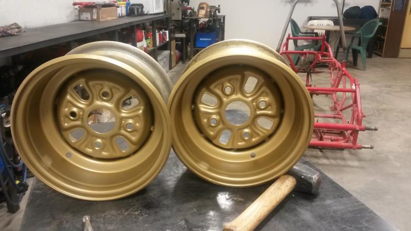

PostPosted: Sun Oct 22, 2017 1:57 am
I did the other front rim tonight and dialed them both in with a dial indicator.
Welding tomorrow and I still have to drill new valve stem holes.
Stock was 6" and now at 3 7/8".
So basically each wheel is about 2" out further than the stock one.

PostPosted: Fri Nov 03, 2017 10:45 pm
Done.

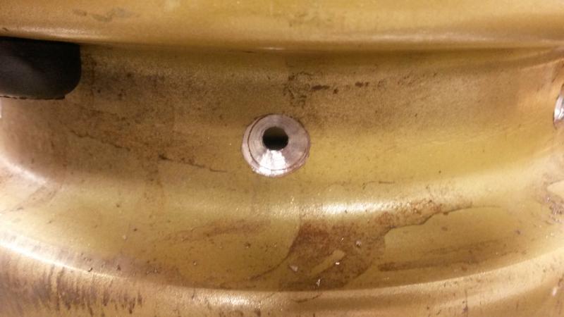

PostPosted: Fri Dec 29, 2017 8:45 pm
Update:
Well my buddy just tried to put on one of my tires onto the rim. Unfortunately my welds were bad and I have an air leak at every spot I welded. Moral of the story do a good job welding. I'll fix them.

Yeah I was thinking similar because if I weld it again and still have a leak then I got seal it anyway.
I was using flux core wire so that was a mistake. Should have used stick or miki wire and gas.
