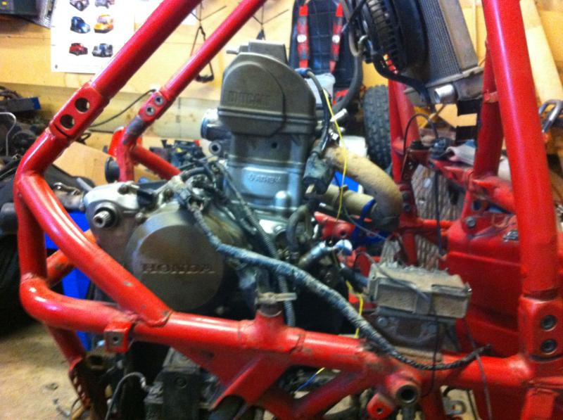

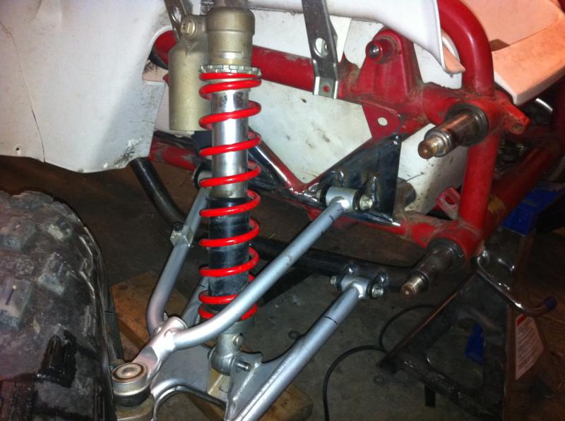

well i have been busy working on my second oddy. sad thing is both oddys have blown engines right now. so that's why i have turned my focus to the second one that i bought. going a new direction with this one. when i bought it i had a non running 400cc yamaha street bike Engine. i was able to get it running but it was only running on one cylinder, and the clutch wouldn't work. so i bought a trx 450 quad and thought it would be great in the oddy. but before i started the tear down of the quad i wanted to take it for a good ride, and just like everything i pushed it past its limits. it had what i was told a big bore 490 in it, stock cylinder was bored out and a steel sleave installed, but something went wrong and the skirt broke and and then it split the cylinder and water jacket wide open. just my luck. this i what i have got done so far. front suspension done just need to biuld another bump steer kit for it and brake lines.
today i made some Engine mounts and got the sprockets on, sorry no pic of that yet

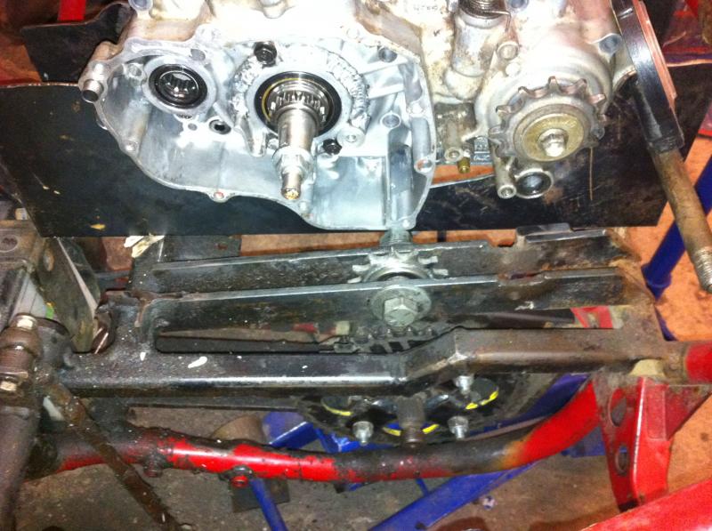

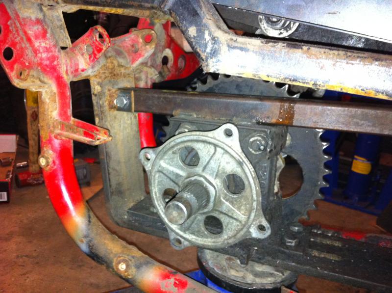

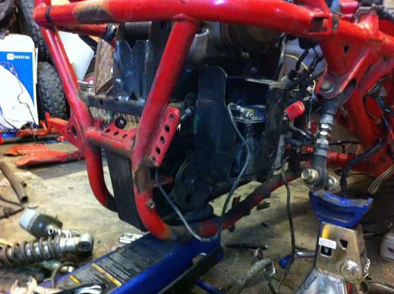

PostPosted: Thu Dec 06, 2012 9:20 pm
heres some pic.
the motor (( Internal Combustion Engine ? )) mounts arent mounted yet, they still need bracing and gussets for strength and support. the sprocket not really happy with but it does what i wanted. i had to add those tabs, and cut the old sprocket off leaving the tabs, had to have the offset for the everything to work in the small space. available for it to run. but this way i can run any sprocket off a trx quad now. i am also going to need a disc brake for the other side, the quad disc wont mount on to the mount that i have.

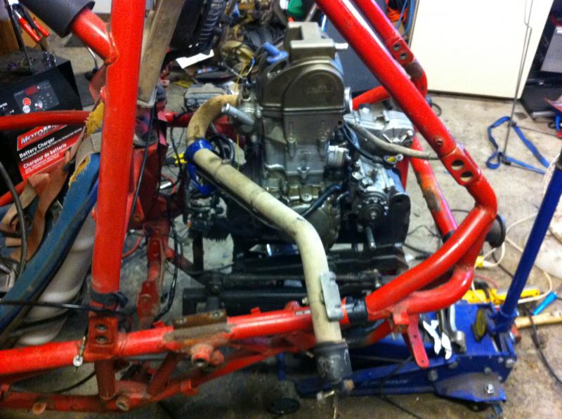

well took week off work, so i got three weeks off now, back for vegas had a great trip there. but its time to get back on this project. i bought a new big bore 490 cylinder and piston for it. so now i need to get the Engine rebiult and back together. need to figure out the wiring on this thing and get the steering done. exhaust and intake will take a bit to figure out. really cant wait to ride this thing and shift threw those gears.

What happened to those Engine cases ?
 Post subject: Re: fl450r
PostPosted: Mon Feb 25, 2013 2:54 am
Not sure what u mean. Then Engine is torn down in the photos. There are no outer cases or gears on it
PostPosted: Mon Feb 25, 2013 2:56 am
Crank bearings welded ?
PostPosted: Mon Feb 25, 2013 9:57 am
Yep, in your pic file 0727...the image in the top half showing the Engine with the side cover off...there is a massive weld seam around the crank bearing. That ain't stock! lol Either its a repair, or the case was welded up and machined for bearing inserts. Generally, its the clutch-side that gets an aftermarket insert. So this is likely a repair. It looks pretty clean though.

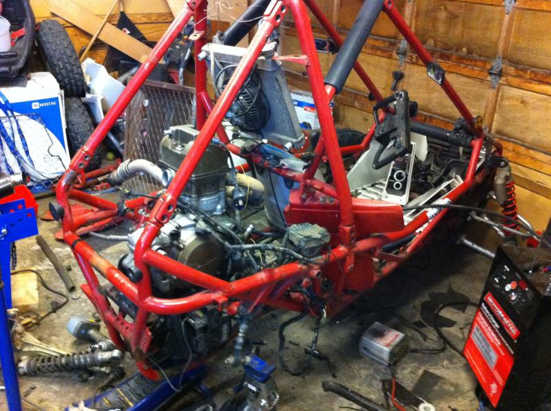

got quite a bit done last couple days. Engine is built most of the wiring is figured out. theres alot of sensors on this thing. thinking of possibly using the headlight from the quad as well. would be alot brighter than the shitty stock headlights. also using the rear tail light with brake light.

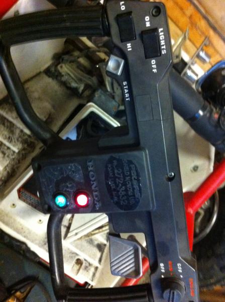

got the wiring finished up, front headlights and tail light and break light light up. just need to figure out how to mount the brake light switch to work with the front and rear brakes

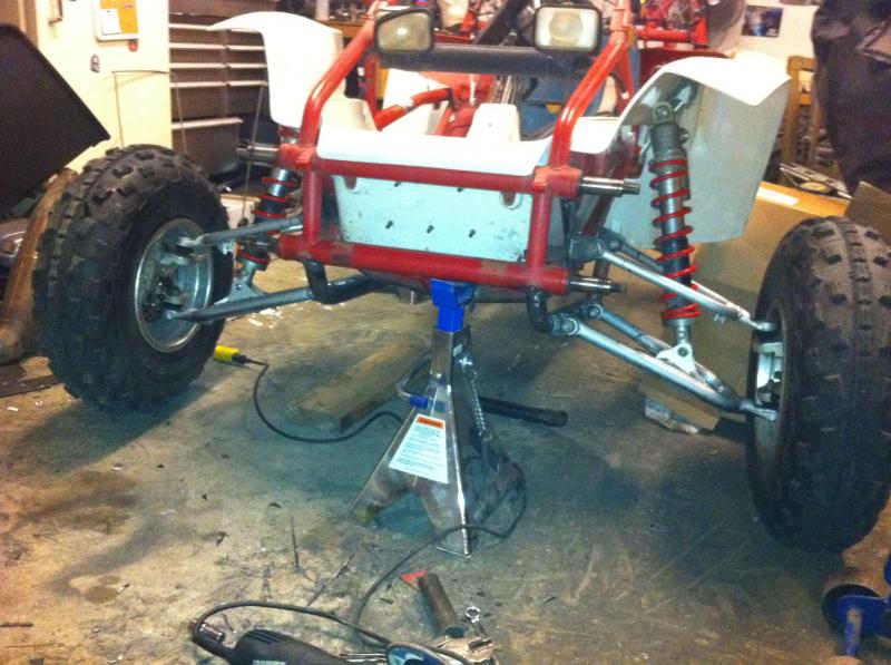

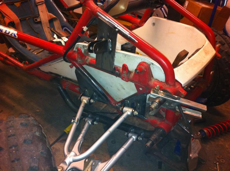

not much to look at but i will snap a couple pics and post them. soldered all the wires. i didnt want to tear into the harness, but had to in a couple spots. everything works on the steering wheel as it should.
PostPosted: Wed Feb 27, 2013 7:25 pm
heres a couple pics
