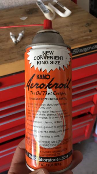

Try using this instead of the pb blaster. I've had good success using this on horribly rusted parts.
