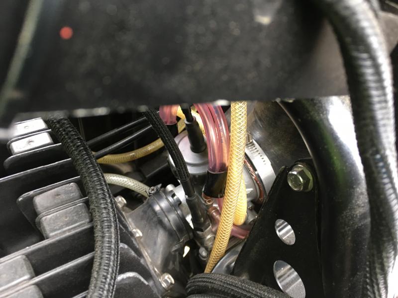

I am really grabbing at straws now but I wonder if your homemade air box has put a steep angle on the carb. If it did then there is a possibility that your floats are at a steep angle and the fuel level in the float bowl is all wrong. You said it wasn't leaking fuel out the carb but you may have a real high fuel level.
Pics please.

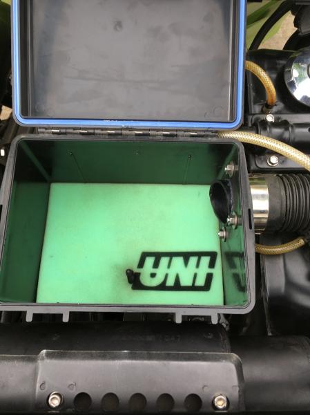

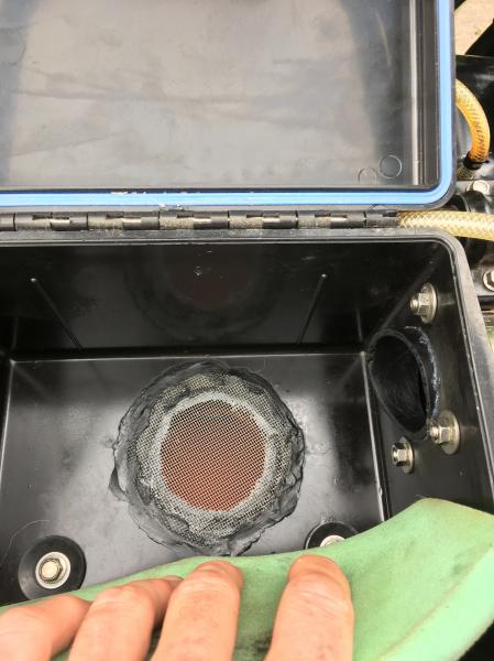

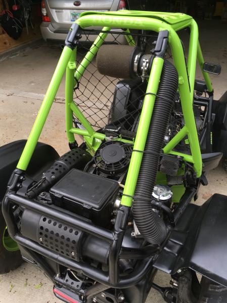

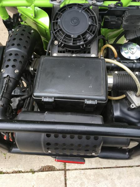

Here are a few pics of the airbox setup and carb. Don't know if the pic of the carb is of any help. You all know how buried it is down there. The airbox itself is a waterproof dive box measuring aprox~ 9"L x 7"H x 7"D

Well I'm glad I asked about your DIY airbox and pics because I see fundamental flaws.The filter foam sheet you use is ONLY being utilised and CONCENTRATED at the carb inlet hole.Its not supported away from the hole and surely just compresses while it gets sucked down and compresses against your wire gauze.Secondly the small gauze is taking up robbing your small hole...starving for air more and more relative to throttle demands.Also your upper duct has a big loop in it comming down into your airbox hindering straightline air pull.How big is the gauze hole? Try running it with the foam out.That will see if the foam is compressing shut.Your gauze as well is taking up too much surface area.
PostPosted: Thu May 10, 2018 3:14 pm
OH MY
That what I see to.
The other thing I see is that foam seems to be from a foamy mattress. I don't think that stuff is pourous enough.
Like bugeye said run it without the foam for a test.
PostPosted: Thu May 10, 2018 11:29 pm
From what I see there, I don't feel you need a filter inside that box. You have your filter up high at the end of the snorkel. If you look at the stock oddy set up it has an air box up high on the end of the hose where you have your filter. Then it has the foam filter inside the air box above the carb. This filter is supported by a cage to keep it off the carb inlet hole. You are choking your air flow off to the carb with that second filter you have laying over the hole.
By the way very nice job on that air box.
