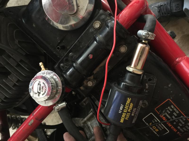

Why is the factory fuel pump so finicky? when I first got my 350 it had the stock fuel pump, in the first thread I posted u can see all the bad stuff going on but it was not pumping nearly enough fuel even when first got it, second pump was one I got from eBay, cheapo Chinese pump that never even worked, third was from chucklenuts at aftershot motorspurts and it worked... for about 6 run hours? 7? Now it’s dead again, pulling 1.5 ounces per 10 secs. I’ve got good Engine compression 146psi, just did a top end rebuild everything is in top shape... I just did a leakdown test twice again it’s good, all my fuel lines are new, fuel filter is new and I put compressed air down all the lines to confirm there are no blockages. Why did the pump stop working? Maybe somebody can help me understand that....
But I was thinking why not go to electric. So I did some playing around...
A buddy had this pump and regulator layin around and donated it for my experiment.
The pump by itself puts out way too much fuel, almost as good pressure as my garden hose... but using the regulator I hooked up all the lines and set it to pump 5 ounces per 10 seconds, as close as I can get to the speed the vacuume pump should run, it seems the T relief valve can handle the extra flow fine. Plugged the line to the vacuum going to the case and started her up, I didn’t run it around as it’s pouring the rain today but it seemed to idle fine.
Does anybody use electric pumps on their setups? Anything I should know about doing it this way?
Seems to be an enixpencive way to improve reliability... especially if something like the fuel filter were to get gummed up... I can increase flow easily to help in a bind on the trails

That electric pump is not gona work in my opinion. Its just gona over power the system and flood the carb.
From what I read here you now have a good Engine that passes the leak down test, has 146psi, and your fuel lines are new with a new filter.
I re-read your post when you first got it. You said the tank was rusty but you cleaned it. You also say you blew air down the lines and apparently they are clear in the tank. You have gone through several fuel pumps now. I find it hard to believe they were all bad. In fact the one from chucklenuts actually worked and then stopped suddenly.

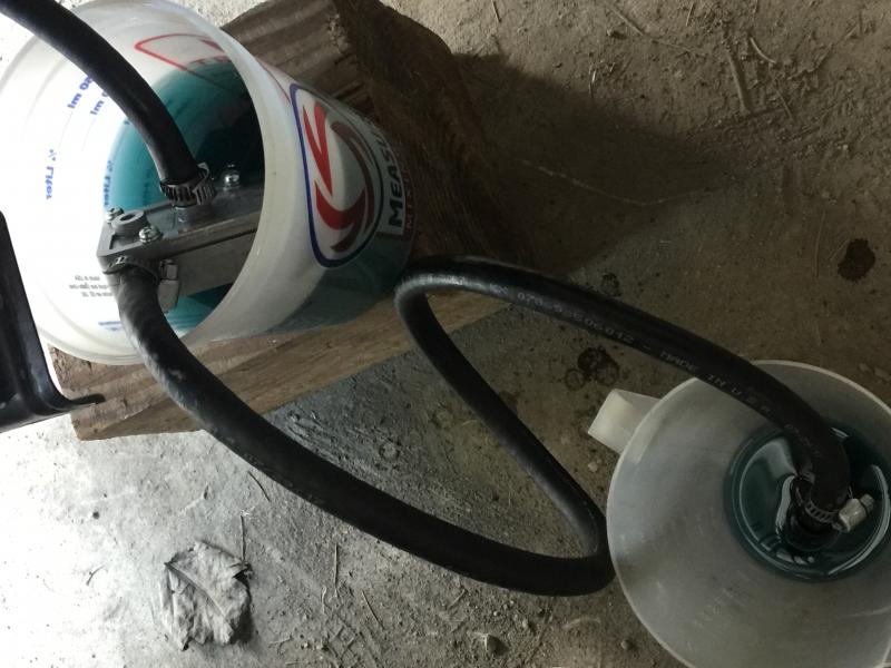

4-5: I do the flow test at the check valve... question on this... should fuel always be flowing out the carb line and the overflow line, even when there is no back pressure from the carb? Cuz come to think of it’s always spraying out both ends...
Pickup lines in the tank did cause some resistance even with the electric pump... BUT when I did the vacuume pump test i tried it with putting the pickup lines on the tank aaand just dipping it in a 2 gallon gas can and it wouldn’t pick up from either.

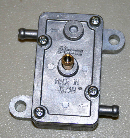

http://www.mikuni.com/c-fuel_pumps.html
DF44-211
Outlets: 1
Flow: 14 Liters/Hour
Be careful as there are Chinese copies ((( cheap ))) Nasty
Buy genuine. spend the $$$$
Dump the electric pump
verify the pulse line is connected and working.

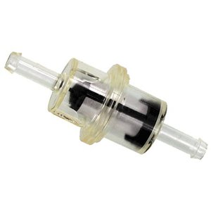

Fuel filter as per pic
Fuel Filter Walbro style - 1/4" OD
Buy good quality fuel line
wyeeoddy

Ok i followed yalls directions, took all lines apart and tried again, best i could. Everything is hooked up properly:
All lines are clear
Vacuume line is clear and when i turn the Engine over without the vacuume line connected to pump i can feel the the air pulsing.
Pump is clean, all lines hooked up correctly, valve on correctly
I tried it with and without the fuel filter just to be sure it wasn't causing resistance
Still it wouldn't pump.
The only way i could get the pump to flow fuel at all is if i Submerged the pickup port on fuel, even then it only pumped fuel at less than 1oz per10sec. And only pushed it out of the tank return line of the valve...
So by what your saying this should mean the check valve and the pump should be dead correct? If the check valve is shot could that cause the pump not to pickup?
F.Y.I. pump im using is the exact one shown by wyeeoddy mikuni markings included... that's the one i got from chucklenuts at aftershot motorspurts.

1) pump is ded
2) NO

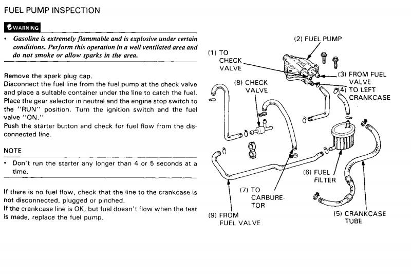

The Check valve is on the output to the carby I hope
see pic
PS u got service manual

Yeah i have the manual, check valve on after pump going to carb as manual diagram says
After determinine the pump wouldn't pull i unplugged the check valve and blew air through it as the manual tells you to, it was leaking air in almost every direction its not supposed to so im probably gonna pick a new valve up too.
