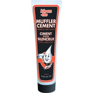

I have done the silicone thing as well but it don't hold up for very long.
I use muffler cement made by kleenflo. See pic below. By the way it don't last forever either.
You could go to a race shop or similar place that sells performance stuff and buy some header wrap. Then make one wrap or two around the leak area and hold it in place with some safety wire. I have not done this myself but I don't see why it wouldn't work well.
A long time ago I thought about making bolt together flanges but ditched the idea because of Engine vibration. The exhaust and Engine must be able to flex or you will break the flange bolts on the Engine side. They are very small and threaded into aluminum.
Just a thought.

PostPosted: Wed May 23, 2018 5:48 am
Posts: 916
Location: Tallahassee Florida
It will just leak through the header wrap and soak it with oil. Also if you're exhaust is not stainless header wrap will rust it up by holding moisture against the pipe.
PostPosted: Wed May 23, 2018 10:26 am
Yup -- valid points.
