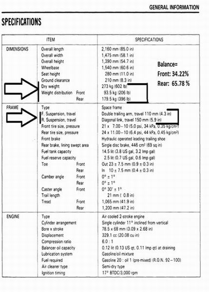

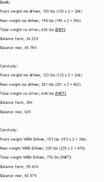

Here is a few pics why i need the numbers.

You can see from the numbers that the way the spring is set for that shock will have a impact on handling.
The % and bottom out as well as others will effect the traction forces available. Once i have the rate per inch I will have more to say on available traction. Cand ody can elaborate on this as he was a driver. For a quick example would be spring rate effect on rebound damping and load at a given point on the tire. This will change the the way the car carries through the corner based on available traction on that tire and the adding or removal of weight from the other tires. Basically the change from over to under steer. Hope I said that right, cand ody can verify.
Adnoh
