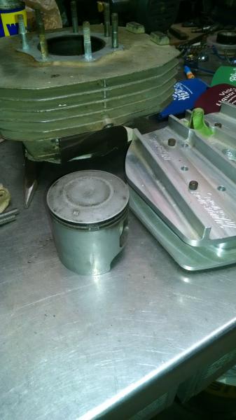

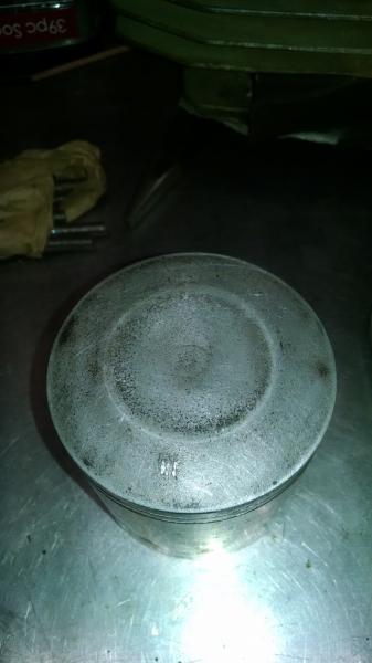

Getting another Engine ready. On 78.5 bore. Piston maybe usable? Here's pic. Can't find rings but found some nos Honda for a 78.5 piston. Will they work as long as I get end gap to speck and fit in ring grooves freely. Have hillside head for this one.

To ansawer your question. Ring,s a ring. As long as it set up correctly.
The only thing that would change if set up to work is the static installed tension due to it's size. I do not see that as an issue. I base this on the pressure applied during combustion. That is far greater than the static tension. Since it's an arts tapered ring make sure there the same angle thickness ect.
I say yes
My wife said they will snap
So let me know. I got money ridding on this.

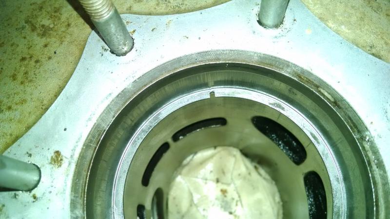

Rings came today fit piston nicely. Here's pic of ring in cylinder. Think they will be fine as long as file down for ring gap.

I'm with Can Odd on this one. It may work initially but for how long is the question!
I'm guessing you are going to see a ring snap because you are compressing it. Even with opening up the ring gap the ring was designed for a larger bore and will be ever so slightly oval shaped because it's being compressed.

Those are the same as I have they are for 78.75 bore. Im thinking they will work only .010" bigger. After putting on piston and seeing them in cylinder think gonna be good. Got bearings for bottom end now gaskets and seals then start assembly.
PostPosted: Sun May 19, 2019 8:39 am
Posts: 474
Ok never posted results of this. Engine running for months no issues. Set ring gap right seems to be fine. Maybe an option if original piston and bore is ok.
