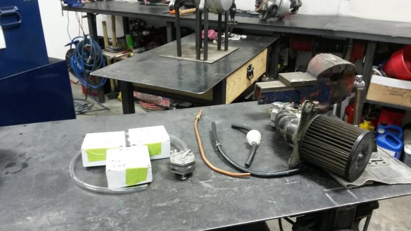

Basically what I have done now is pulled all three "new" pumps out of the plastic n box and tried them all.
So that's a total of 3 new pumps and 1 almost new pump (just one season) all from the same manufacture. I ran straight out of a jerry can with clear line on the pick up (as suggested by zero) and straight into a measuring container (no bypass line). Then I hooked up the vacuum line to one of my spare engines and also to one of my running machines. All pumps put out 2 -2.5 oz in 10 sec regardless of which Engine I tried them on. I checked the pulse on the vacuum lines as well and they were the same so all engines are good. It's a pump issue for sure.

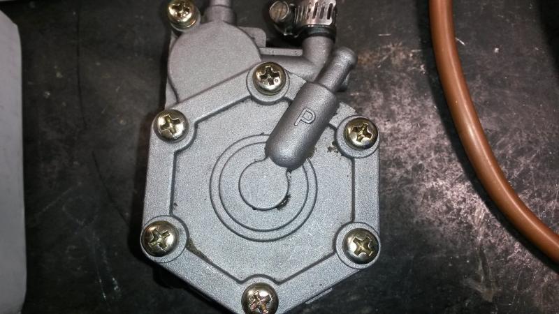

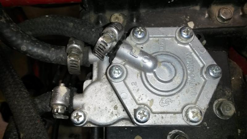

So now I look a bit closer. All of my spare pumps are Chinese and the two running machines have Japanese. Well you guys can shoot at me now because I know I have said many times that I have no issue with Chinese, and that was true until today.
Why did I buy these ?? ----- I'm cheap. The Polaris Japan ones are almost $100 here.
How do you know if they are Chinese ?? Look at the pics below.
Japanese ones have writing on the top and the Chinese ones don't.
So at the moment I have given up until I get time to see if I can "fix" these or if I have to buy Japanese.
File comment: Chinese
File comment: Japanese

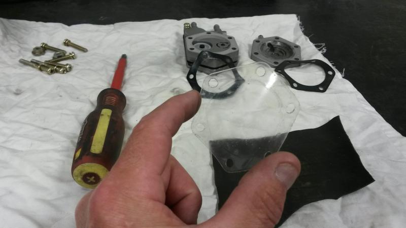

Well I played around with this a bit today.

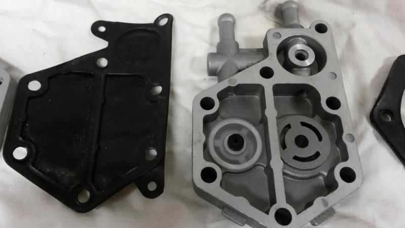

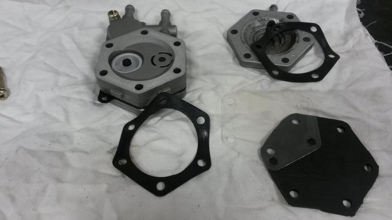

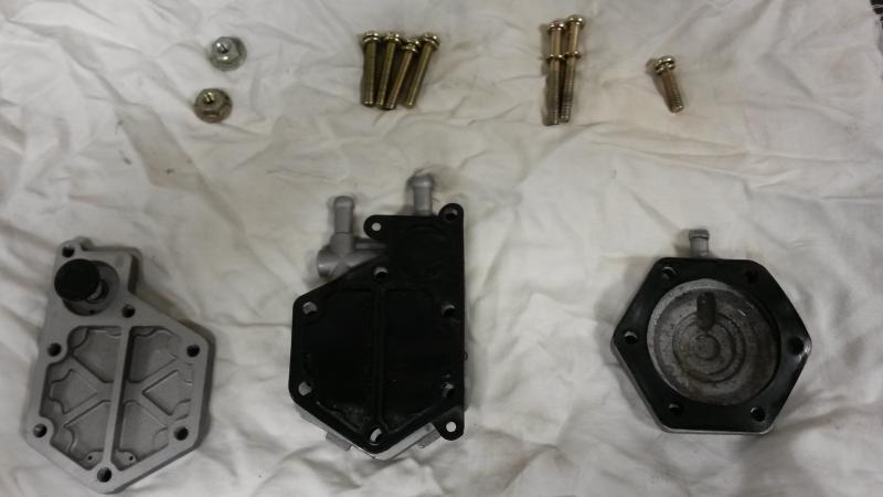

I took a spare Honda "T" that I had in a box and put a rubber cap on one end. Then checked to see which way this check valve worked. I hooked this T check into the pickup line on one of the pumps. It didn't draw any fuel. Then I hooked it into the outlet line and got 2oz flow. I did this to see if the check valves in these pumps could be faulty. They are not.
This tells me that the vacuum part of these pumps is no good.
When I took the pump apart that was on the death machine I noticed that the vacuum diaphragm on these Chinese pumps is made of some kind of clear see through plastic similar to what you would find on something like a display box that a toy is in or your wallet, but slightly stiffer.
My thinking is that these Chinese pumps are not getting a good stroke. I find it difficult to believe this plastic would flex or stroke enough to draw a large amount of fuel. I don't know what is in a Japanese pump and I am not about to strip a good one to find out. What I might do is cut a piece of inner tube and see if I can make a diaphragm. Then test it again. Stay tuned.

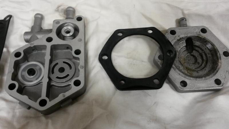

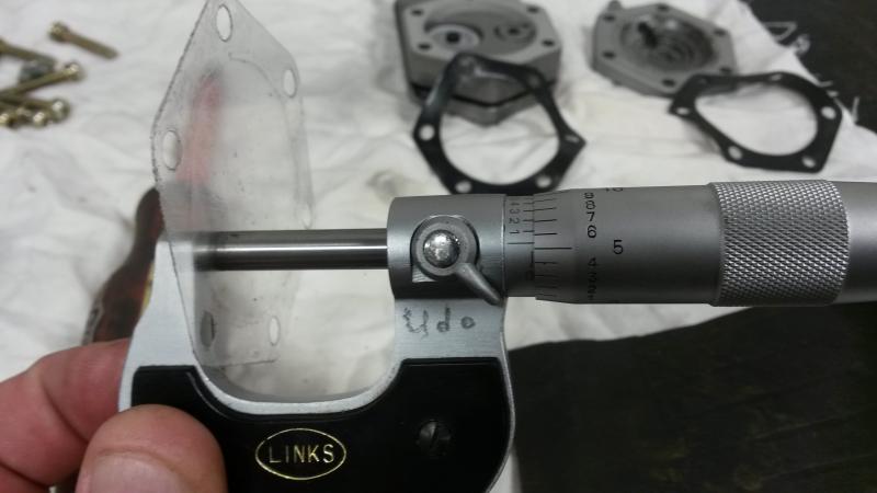

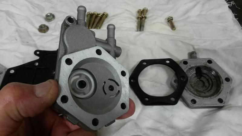

Pics of the Chinese pump internals.
File comment: In this picture if you look at that rubber seal for the diaphragm cap there is actually a clear see through diaphragm but it's so clear you can't see it.
