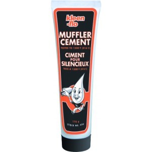

Most guys clean the parts good and use red silicone.
I use exhaust cement by kleenflo.

File comment: This is what I use.
