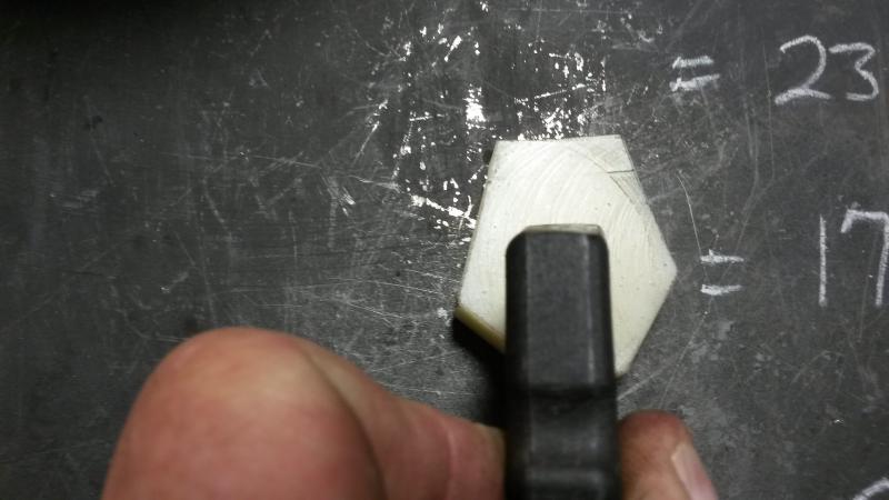

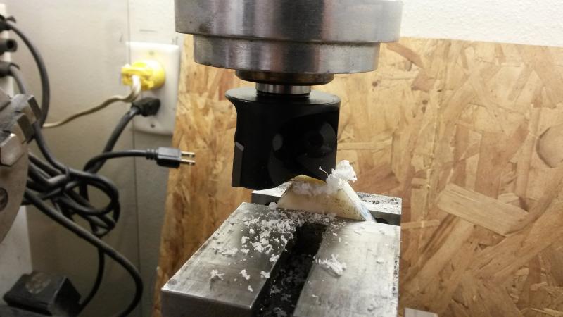

Once again trying to think outside the box (failure IS an option according to me).
Decided to play around with this a bit more.

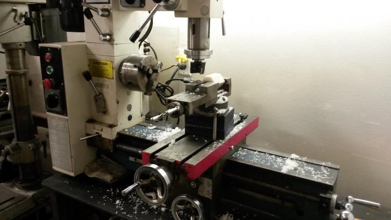

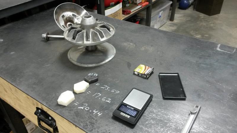

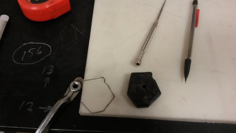

I ordered a sheet of material and cut two pucks.
The first one is a bit under size so this is the one I cut up on the milling machine.
Ran into an issue. The sheet of material is .520 thick and the 94c pucks are .490 thick.
So I ended up milling off .030 so that it would fit.
If you look at the pics you can see that the stock puck is worn at an angle on the engagement side. I bet many of your units are the same.
You will also note that these replacement pucks are a lot lighter based on my dope fink scale.
The original is 23.5 grams.
The one I milled is 17.6 grams.
The unmilled one is 20.5 grams (this one will not fit in clutch).
So it looks like I will have to add weight or just run a lighter puck :-) . This should bring the engagement rpm up. Remember the oddy has it's best torque at 6000 rpm. I will have to look on my computer to see if I got any info in puck weights/engagement rpm.

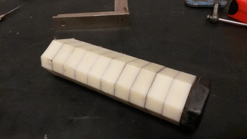

PostPosted: Sat Aug 04, 2018 3:13 am

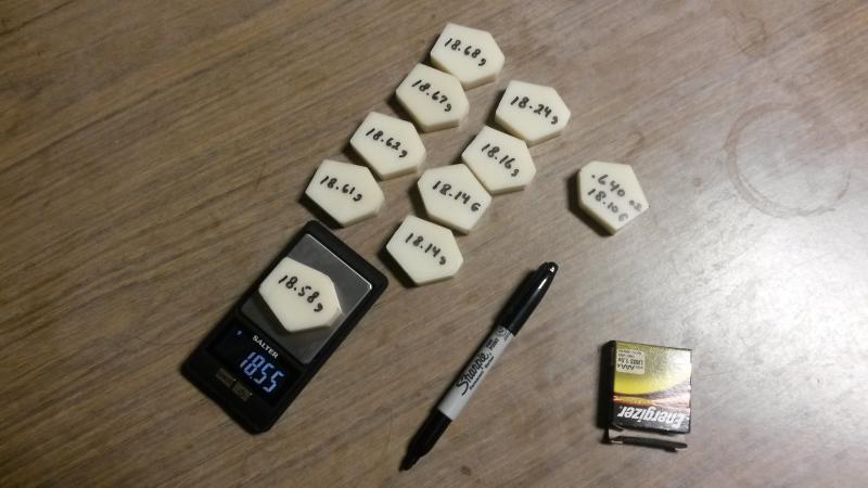

Actually quite happy about how they turned out.
Made 10 of them. Milled 5 at a time.
One set is 19.80g and the other set 19.30g.
So one set is half a gram lighter.
I still have to mill .030 off the thickness on each one, so they will get lighter.
Also have to round the corners and that will take off a bit more grams.
Since these are going to come in around 17g I plan on running 9 pucks with the orange spring. That will get me near the 3400 rpm engagement.

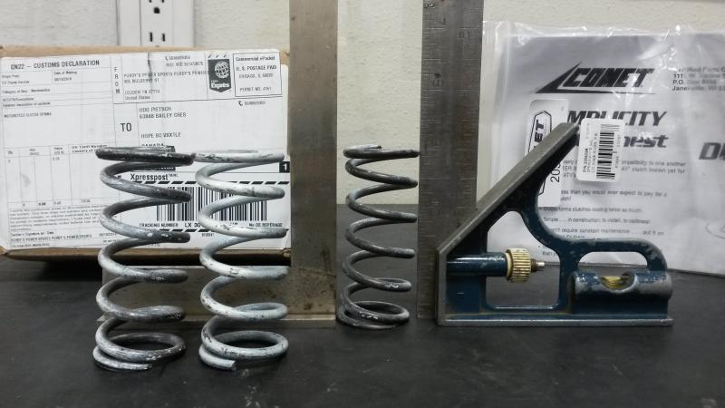

 Post subject: Re: 94c pucks
PostPosted: Fri Aug 24, 2018 6:29 pm
I have removed my 102c and installed the 94c with these homemade pucks on my machine.
Also ordered and installed a "white" spring. Unfortunately there were some issues as the springs that were sent to me were very poorly manufactured (pics below). I did install a white spring anyways and I am running 9 pucks. Based on my best calculation with these weight pucks and a white spring, it should engage at 3650 rpm approx.
We can't go for a run here because the whole province is on fire. There are over 600 fires burning right now caused by lightning strikes. The smoke is so thick it blocks out the sun and it has been two or three weeks of this crap already. The province has declared a state of emergency. I don't foresee going for a ride until late September as there is no real rain forecasted in the near future. That's two years in a row now this has happened in our area of the world. It's very unusual weather for us. There is a fire across the river from me but no chance it will reach me. There is a helo base half mile from my house and they are flying water buckets.

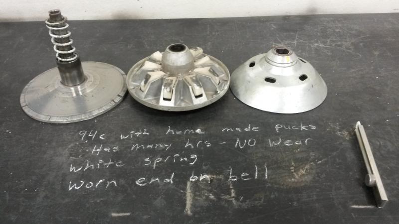

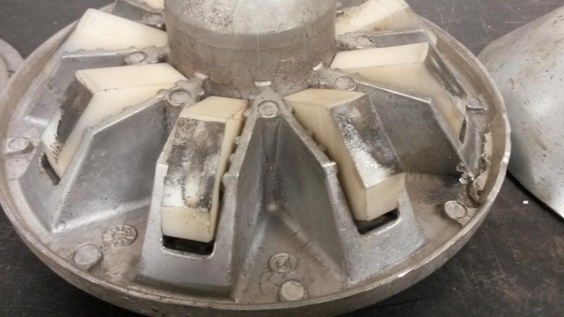

Decided to pull this clutch off tonight. Bored I guess :-) .
It was working just fine but I wanted to know what it looked like after a year of riding and also wanted to know if my clutching was off. What I have been noticing with this clutch since install is that the bottom end was great and so was the top end but as soon as I had to go up a steep hill (that's most of em around here) the Engine would kind of power out as the rpm dropped suddenly at full throttle.
I am running the white spring with 9 of my homemade pucks.
The rpm has to come up a lot before it engages and then suddenly it launches. It powers out going up hill. Maybe I should try 6 of my homemade pucks but that would probably really bring the rpm up.
So now I am running a stock 94c with orange spring and 6 factory pucks.
This will tell me if my clutch is the issue or my jetting or if the hills are just to steep.
We plan on going for a ride tomorrow. Not sure where yet but I hope Hunter Creek.
In the pics below you will see I am running white spring and 9 homemade pucks.
You will also notice that there is NO WEAR on the pucks.
You will also notice that the square hole has been pounded out a bit. Probably from those sudden launches when the spring and pucks engage.
PostPosted: Fri Sep 06, 2019 10:05 pm
Well it's real obvious to me now that my clutching was way off.
We went up the same valley to make sure we are comparing apples to apples.
The stock 94c clutch worked perfectly for me. The machine had power all the way through to full throttle.
That experimental clutch with the white spring and homemade pucks was way stronger on the bottom end but fell on its face at the top end going up hill. It just dragged the Engine rpm down.
So the comet 94c with the orange spring and 6 stock pucks works well for our stock engines with a pipe.
So maybe next riding season I will try the experimental clutch with white spring and 6 homemade pucks instead of 9.
This is the best riding season here now for the next two months weather wise so I don't want to F around with two well running machines.
By the way I did mill off 1/8" on both of these clutches to close up the belt to shiv gap.
