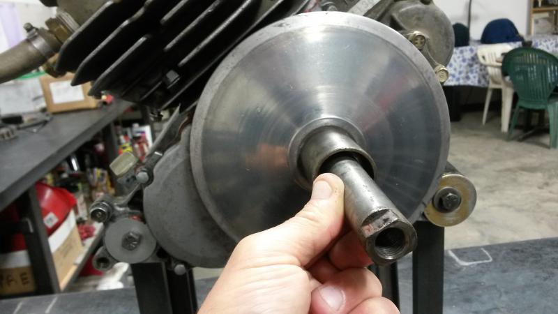

Any of you guys ever seen any of this kind of foolishness ??
This clutch was actually still working but I found it when I had to do the rebuild of my brothers Engine when the new electric fuel pump failed.

is that the end of the crank showing in the second pic? if it is that is going to be a challenge getting that off. good luck
 Post subject: Re: Broken clutch
PostPosted: Tue Aug 13, 2019 3:30 pm
No that's actually what is left of the shaft that broke. The crank is right behind that in the taper.
You are right though -- it will be a challenge to get that taper off the crank.
I do have an idea though :-) .

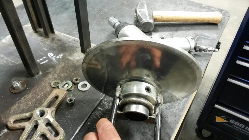

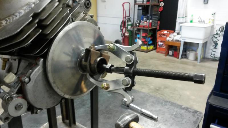

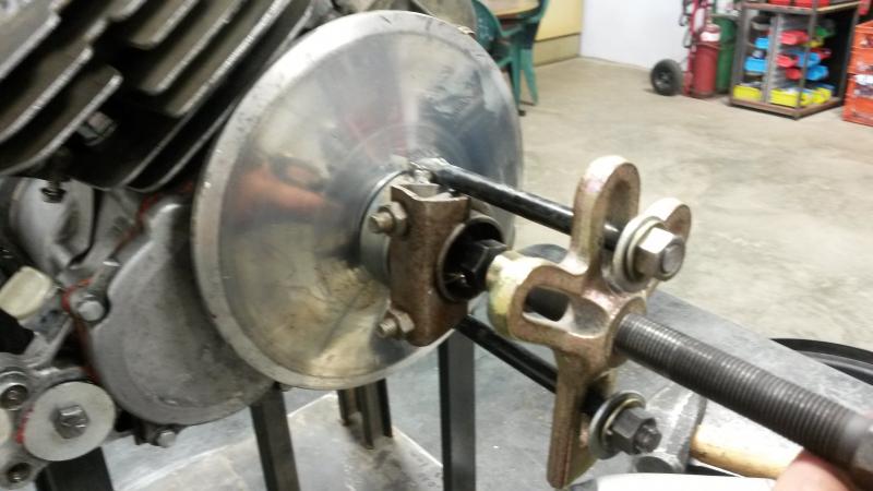

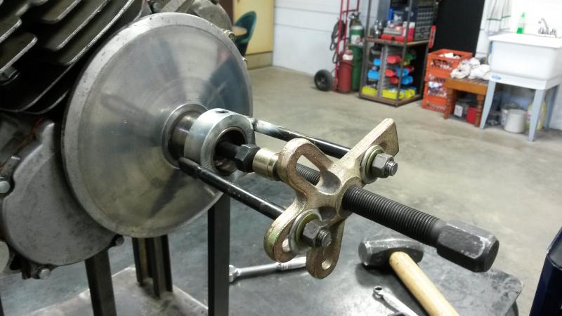

Good thing I didn't make a video. Would have run out of film. It took a bit longer than I thought.
I tried using a muffler clamp and the puller-- it slipped ----- failure.
So then I made a collar and used a different puller --it slipped ---- failure.
Took the dog for a walk.
So then I tried the collar and the muffler clamp -- it broke the tie arm ---- failure.
Re-welded the arm back on the collar properly this time and tried again ---- success.
If this happens to you then you are going to need some tools.
Suggest you get a bag of popcorn and watch the local skillbilly do it.

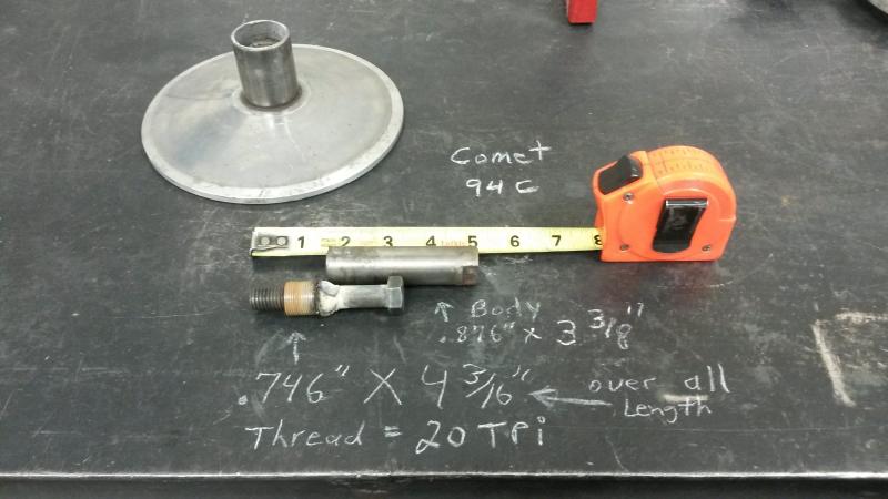

PostPosted: Wed Aug 14, 2019 1:33 am

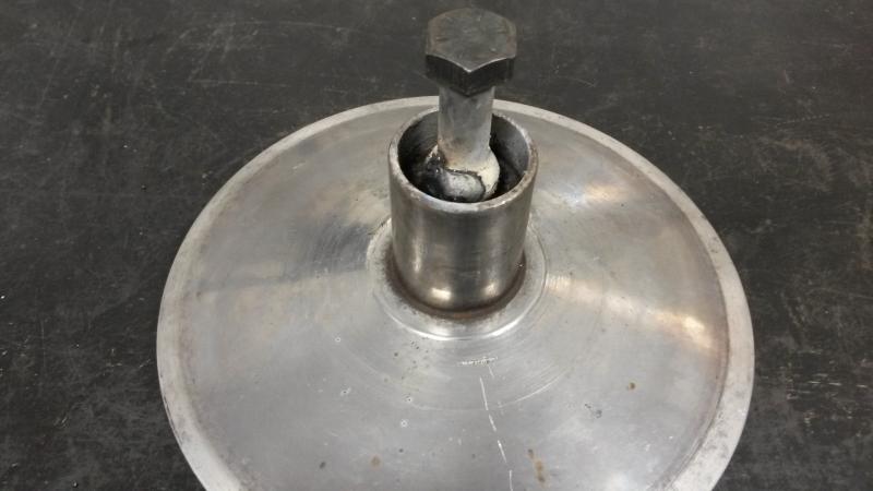

Had some luck tonight.
I welded a bolt onto the exposed broken threads that were inside the shiv.
Then got on it with a wrench quick before it cooled down and seized the threads. The broken piece came out easy.
Also took some measurements of the shaft in a 94c if anyone is interested.
I would also like to say that the shaft should actually be a bit shorter because there is a big gap between the belt and the shivs. I am not to sure yet how much shorter it needs to be because you have to measure this. You can't shim this shaft because we need to go narrower to close up the gap and there were no more threads left to screw it down. It was bottomed out. You could set up this clutch to run a wider belt by adding shims but you can't go narrower.
It looks to be a 3/4" x 20 TPI thread. Body is slightly larger at .876 x 3 3/8" L.
So you take a .876 shaft and turn it down to 3/4" for the threaded area. Then you need to drill the hole for the bolt that holds the whole mess on the crank. I bet a guy can make this easy on the lathe with a piece of cold roll.
CO
EDIT: I would also like to add that the threaded portion of the shaft is 3/4" x 3/4" but the threaded portion of the clutch shiv is only 1/2" in length. So that means that there was a 1/4" of thread poking out the back end. This was probably so that you could shim it for a wider belt. So if you make a new shaft then the threads would have to be longer so you could narrow the gap between the shivs. Then you can trim the excess threads off so that they don't hit the crank when you are tightening down the clutch.

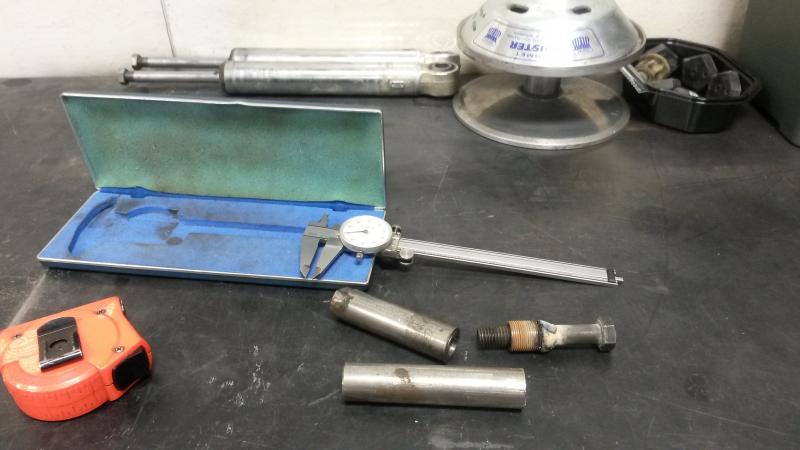

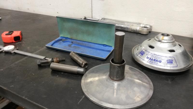

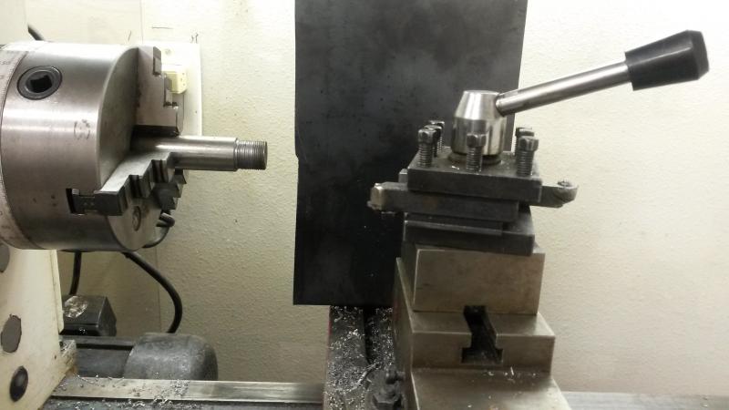

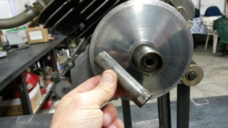

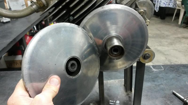

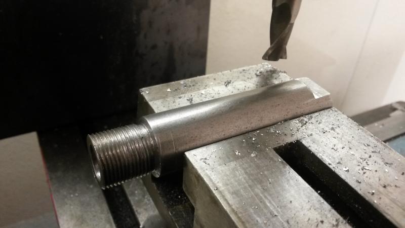

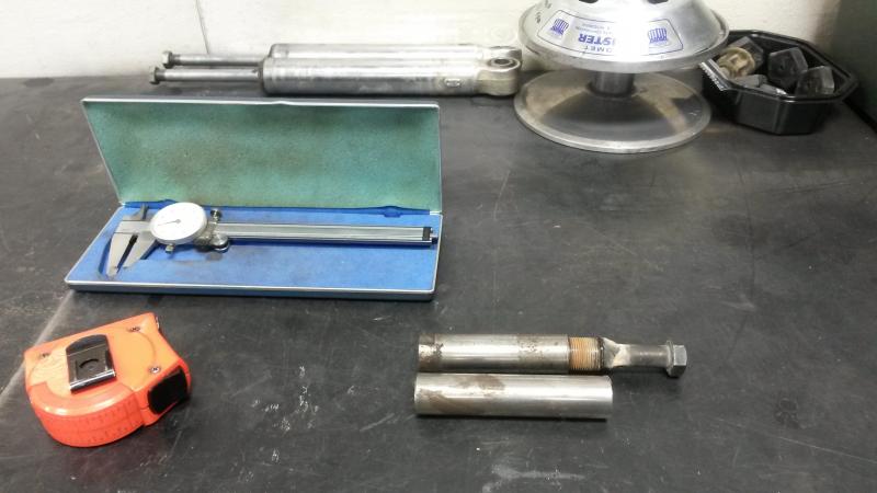

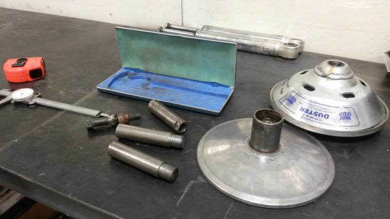

I got a few hours to work on this thing tonight.
In the first two pics you see I cut a piece of 7/8" cold rolled the same length as the old broken piece.
In the third pic you might notice that I use my thread bit upside down. This is done because my lathe does not have a lever you can pull so that the carriage runs the other way, so I have to run my machine in reverse to do that. At one time I owned a south bend lathe and it did have this feature. This one don't.
My machine also does not have a quick change gearbox. That means you have to change gears for every different thread pitch you want to cut.
When I cut threads I run my carriage toward the tail stock. This is done so that you don't screw up the piece you are cutting threads in. If you disengage the carriage at the wrong time or the handle sticks it's gona be a problem. If you do it my way you got all the time in the world to disengage the carriage. Also you don't accidentally run the carriage into the head. DO IT MY WAY.
In the fourth pic there is an extra piece laying there. That's because the first piece I fukdup. I put the thread gear on incorrectly and my machine then cut the threads a half pitch off. FFFFFF. Had to start over. This is the draw back of my comment above about my machine and the quick change gearbox. Sometimes you get it wrong F-ing around with gears.
Pretty sure someone like Meth would fire my azz :-) .
In the fifth pic I made sure the piece fit. Now I have to drill the hole and thread it for the pusher bolt when you remove the clutch. Also have to cut the flats for the outside shiv to fit on.
CO

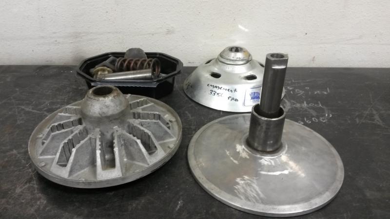

PostPosted: Thu Aug 29, 2019 4:16 am
Well I finished the stem.
Made it a bit shorter than the original to close up the belt to shiv gap.
Then I had to make a shim because I made it to short LOL.
Will install the clutch tomorrow.
We go for a ride Friday. Report to follow.
PostPosted: Fri Aug 30, 2019 12:24 am
liduno wrote:
I feel your pain on the lathe, mine is over 100 years old. If I had to thread something that had a shoulder or was close to the chuck, I would only cut left handed threads..lol
You can cut right hand threads if you turn your lathe bit upside down and run in reverse.
This then cuts a right hand thread with the cutter running toward the tail stock. No danger to hit the head or a shoulder.
That's what I did in this project.
