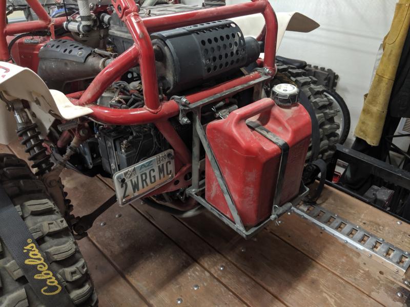

I have added a extra tank, an additional 2.5 gal I can dump in on the trail. It's still not enough for some trails unfortunately.
