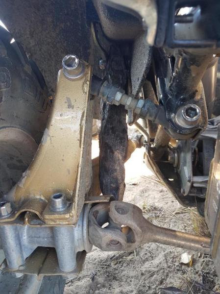

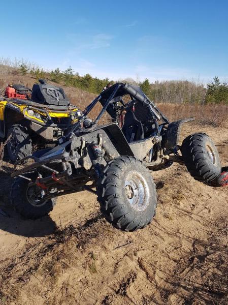

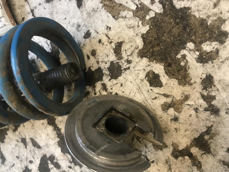

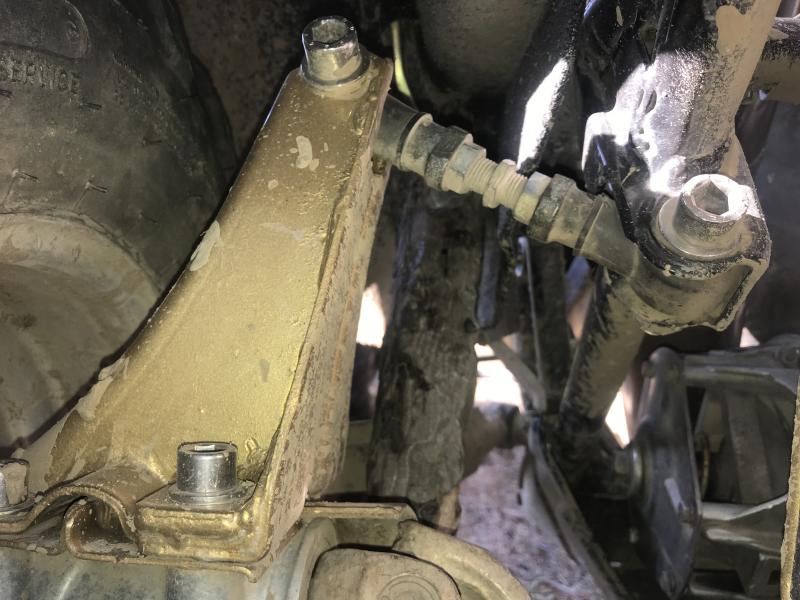

so I broke a shock on my last outing. had to carve a piece of burnt tree limb to fit. haha you laugh but it got me home. so I am now contemplating new fox shocks or a complete rebuild on my works shocks. there are triple rate with a rezzy. is there still replacement parts for these shocks out there? having trouble finding anything.

Last I checked (March), Works was re-opened and servicing shocks as well as building new ones again, same old phone number.
EDIT: Also how did you drill the holes in the wood while on the trail?

that is some awesome work getting home. great job!
I just kept twisting the knife till I made it all the way through. took some time but there wasn't much else to do.
wasn't sure if it was gonna work but had nothing to lose

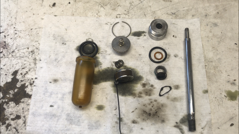

Got the shocks all tore down. Tried contacting schmidty for parts but they never called me back. So I called works. He has to make the new shafts but has everything else that I need. His seal kits are a bit more pricey but at least I know they are the right ones. My reservoir bladders are in good shape and don’t leak so I’m not replacing them.

so I have rebuilt these and it worked out well..one shock does seem softer than the other, not sure why.
I wasn't sure how to put the cross over rings back in. I just talked to works, and after preload is set, the top spring should have about 3/8' gap before is hits its stops, the second spring, should have 1/2-5/8's, so I need to pull them apart and redo this..also I might change oil and check to see if I did anything wrong in the one shock to see why its softer. need around 2" of sag according to works which seems like a lot to me.

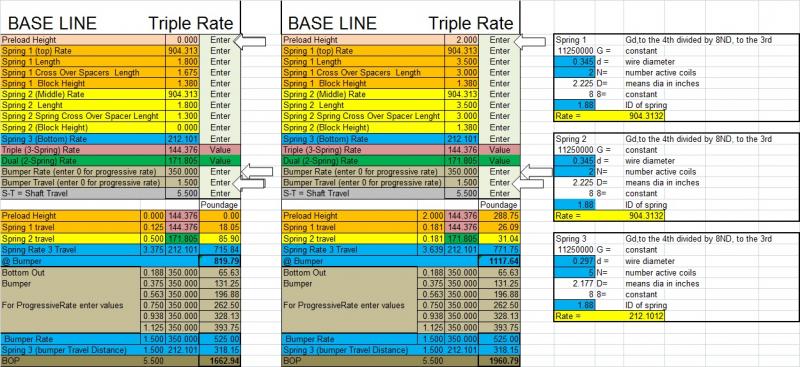

Here is what I come up with as a base line. What this does is show poundage at shaft. This does factor in any up or down travel poundage based on sag or ride height. That is a different sheet.
What I like to do to establish a sprung weight to go further is place the known 210 rate on the machine at zero preload. Basically run that nut down until it touches the single 210 spring and put on machine set in it and have some one measure the shaft length. with the shaft travel we get a sprung weight to do more with. lets say you have a 5.5" shaft travel. Then you measure the shaft and have 4 at ride height with rider. that is 1.5" of shaft at 210 or sprung weight of 210 x 1.5=315 lbs of force acting on the spring without a bunch of math crunching. Now we can look at the numbers from the pic and evaluate what to do with out big guesses. Its fun to play with
Remember this is just what I come up with. I'm not a professional in any way.

If you look in the pic at the 2" pre load you will see that the 2" + the .181 of an inch (314.84 lbs) has used up your ride height sprung weight # so you will be at a shaft travel of .2 or so. That's not good. remember this is just an example base on a made up sprung weight number.
Now compare this to the zero preload pic. Spring 1 and 2 are at .625 travel and 103.95 lbs. Your next rate is 212.101 per inch of shaft. 314-103.95=210.05 So your ride height would be close to 1.625 inch of shaft travel. You see this is a little more than the sprung weight # of 1.5 inches of shaft at 210 IN/lb/ Rate.
With this information you can make changes in the spreed sheet on spring and rate to get desired BOP Bottom out poundage and Ride height as well as a shaft force rate per inch and graph it out. You do not want a low ride height and large BOP at a fixed valving that can not be adjusted. It will be a very harsh ride.
Now look at the shaft at bumper and the rates involved to BOP you will see where a progressive rate will smooth out the portion of shaft travel verses a liner or straight rate per inch. This will reduce the harshness from bumper to BOP and proved a greater BOP as well maintaining a good ride. Since your valving so called can not change. This is where with a shim stake you can add a flutter stack and pick of the higher shaft speed and smooth out the hit and maintain a good ride. A hard landing is just as bad a g-out or sharp edge hit like a cross rut they yield a very high shaft speed.

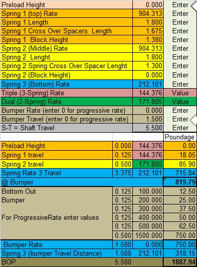

There is a minor error in the first pic.
Here is a pic to compare to the zero preload and linear rate bumper. This time I used a progressive know rate.
Added 225 pounds to BOP and smoothed out the hit in rate per inch. If we only knew what the stock was.

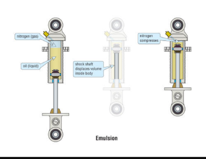

Couple pics pulled from web

Cross overs
Look at your video where played them out.
You can take each set and measure the thickness per piece and match side to side.
You can also use a smaller one from middle and move to top and cross over the triple rate sooner to the dual rate. Pay attention to the skidders to be sure there the same on the lip top and bottom. If different you can flip the thicker on top and cross over sooner.

The valve stacks when I pulled them out I zip tied them up so I would not lose anything in them or the place they came out of.
I would like to think I got all the air out but who knows. I might take them apart and change the oil on them. Make sure I got no air in the system
I need to redo the cross overs and set the ride height/sag properly.
