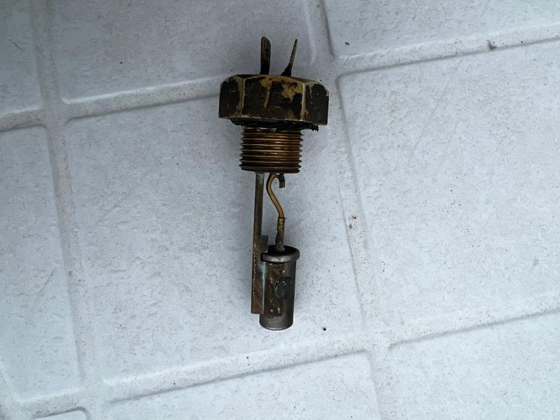

Hey Lee - is it possible for you to get some tech data on the pilot fuel sensor thermister? Part number 37810-MS8-008. The part is discontinued, but the old ones can be repaired. You can see the Thermister in the picture below. See how the round disk came off the wire. Anyway, to replace this i want to make sure I buy the correct thermister. there are different syles PTC na NTC and different ratings. Any info you can get will help.

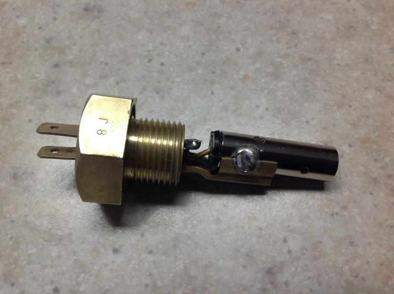

I found the thermistors that are used in the sensor and purchased a couple for about $1 each. I soldered it in place and it works great. I coated the outside of the sensor with epoxy just to make sure it was sealed and to stop it from grounding out if it makes contact with the side of the can. It takes about 60 seconds when there is no fuel around the sensor for the light to start to glow. In another 60 seconds the light is on full brightness.
Here is what I purchased:

Received the new thermister and installed it today. With the sensor plugged into the wire harness just hanging outside the tank, I turned the key on and about 25 seconds later the fuel light started to glow then went to full bright. Very happy to find the part and get this discontinued part back in working order. I even used some brasso cleaner before I soldered it together and it looks like new.
Probably the cheapest and easiest pilot fix I have ever had. :-)

Hi Guys, Just to bring this up to the front again, can one of you helpful people confirm exactly which thermistor i need to repair my 89 Pilots fuel sensor please ?
