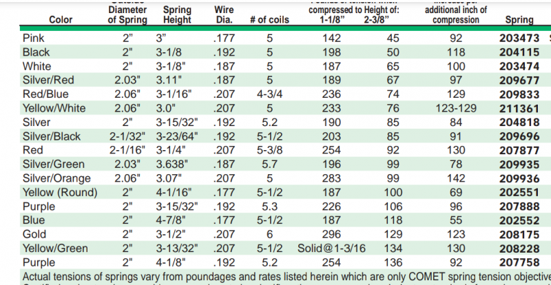

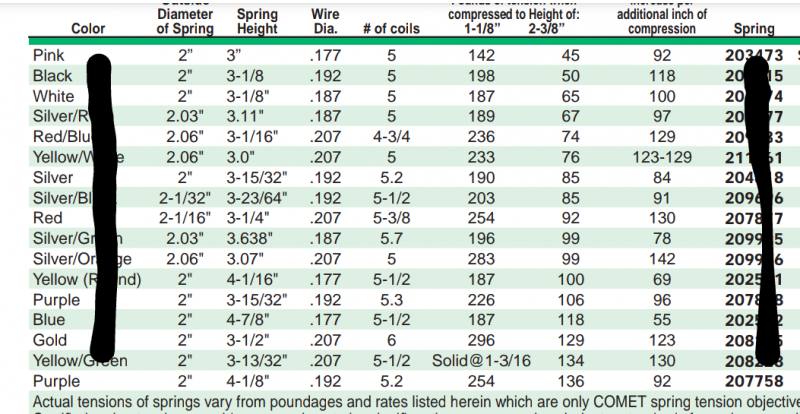

Cool info
A is missing from list. Hope it is the same as pictured.
