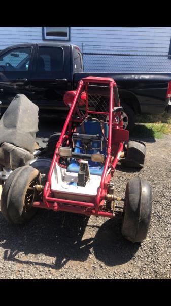

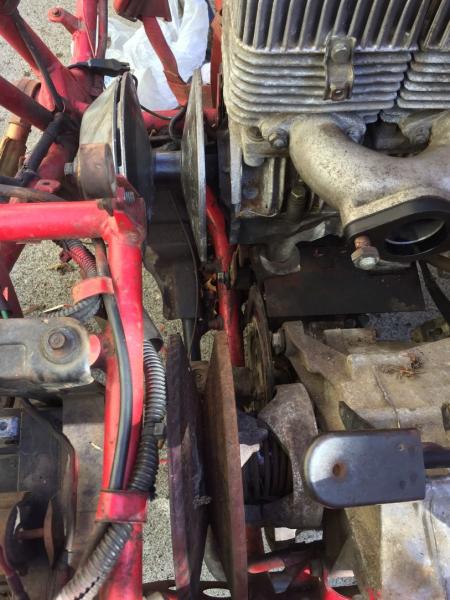

Hello,
I recently bought a FL350 that has a 70's 440cc (KEC-440) snowmobile Engine swapped in it. I pulled the Engine and got it running, problem is that the Engine is too wide for the frame, so the belt on the drive clutch is not lined up to the driven clutch. The previous owner ran it this way, but I am not wanting to go through a belt every time I take it out. I can't move the Engine over any farther. I suppose I could delete the pull start (seems risky).
I am thinking the best option is to just swap the Engine entirely with something newer (maybe 90's?) that fits a bit better. I do not want to do a ton of modifications, as I want to leave the possibility open to put back in the original Engine (if I can ever find one). But for the sake of time and money, I am looking at swapping in another snowmobile Engine that will give it equal or more power than the original Engine, but can still run off the stock transmission.
Is there a go-to, budget Engine that is a fairly easy swap? I have seen some builds on here for rotax engines, but they seem like they might be a little overkill for the trail riding I plan on doing. I live in Oregon, and am finding some cheap ($200-$400) snowmobiles on craigslist/facebook/offerup, I am just not sure what I should be looking for (make, model, size). Any recommendations would be highly appreciated.

Yeah that won't work. I bought an FL350 that had a powerbloc clutch with the wrong offset. The belt lasted minutes.
4) I don't really have an answer for you on an "easy" swap. You might have to mod what you got.

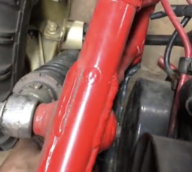

I don’t know of any bolt in options, but if the Engine runs I would fix the existing setup. We just put a Rotax 500 in our FL350, and I know exactly what you’re talking about. We had to notch the frame on both sides to give an extra inch or two of clearance, then notched the mount so it could be adjusted left to right, and forward to back. I’d say all you need is to pull the Engine, and modify the mounts to accommodate. That’ll be a lot easier than starting over with another Engine.
Below is a pic of how we notched the frame, if you want more detail below is also the link to the video where we were building. I think it shows the Mount very well.

We used the aluminum mounting plate out of the sled and put it on a really simple Engine mount we made. Basically it was just a piece of angle iron, that video shows it pretty well.
As for the cvt we kept the drive pulley off the snowmobile, mated to the driven pulley off the FL350. This setup works pretty well, but we may swap the driven pulley at a later date to be a proper match for the sled drive pulley. As for the gearbox I believe it will reasonably stand up to about 50hp, which both our engines should be below. When you start putting 100hp engines in everything gets destroyed. I figure Honda used at least a 50% power buffer on their drive train. So the old 350cc put out around 37hp, add 50% and you get 55.5. That’s how we decided on a Rotax 500, we wanted an upgrade from the old 350cc, but didn’t want to have to swap transmission, gear box, axles......
