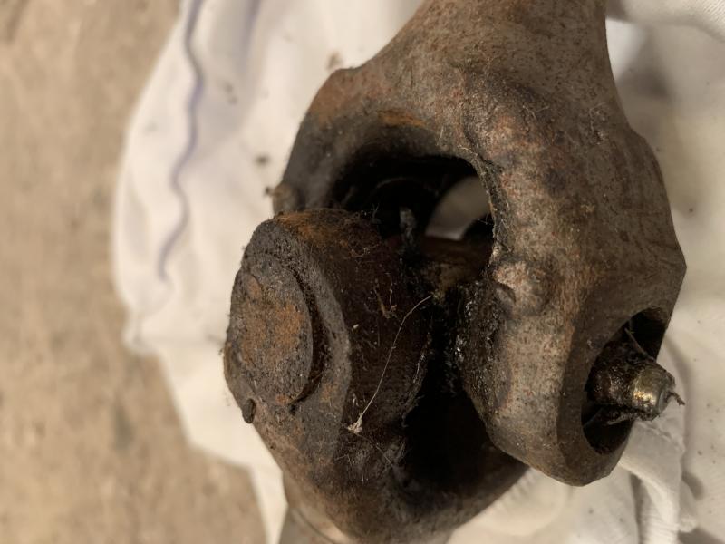

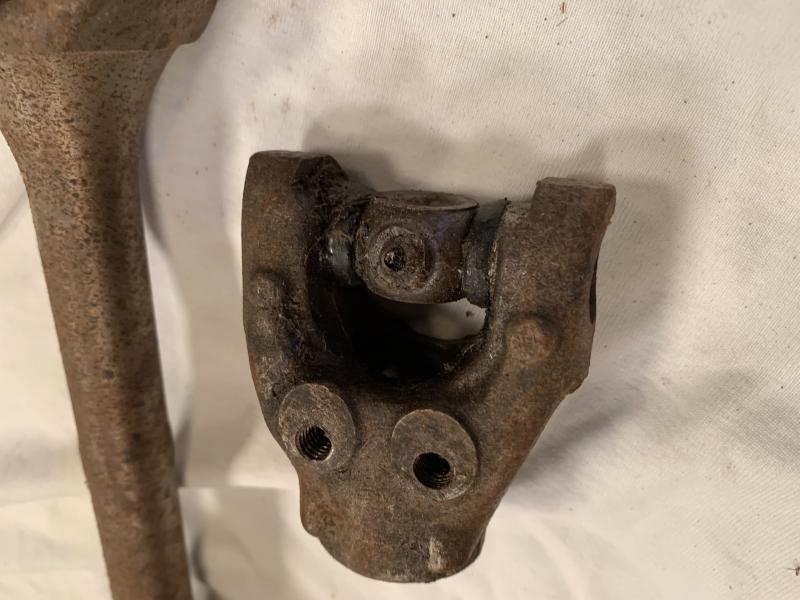

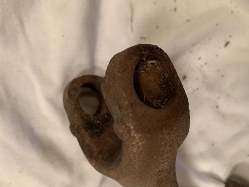

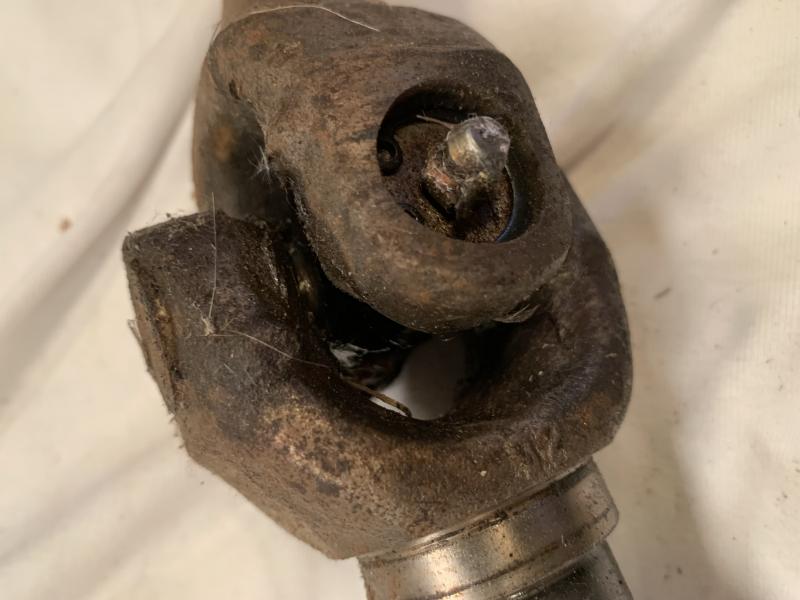

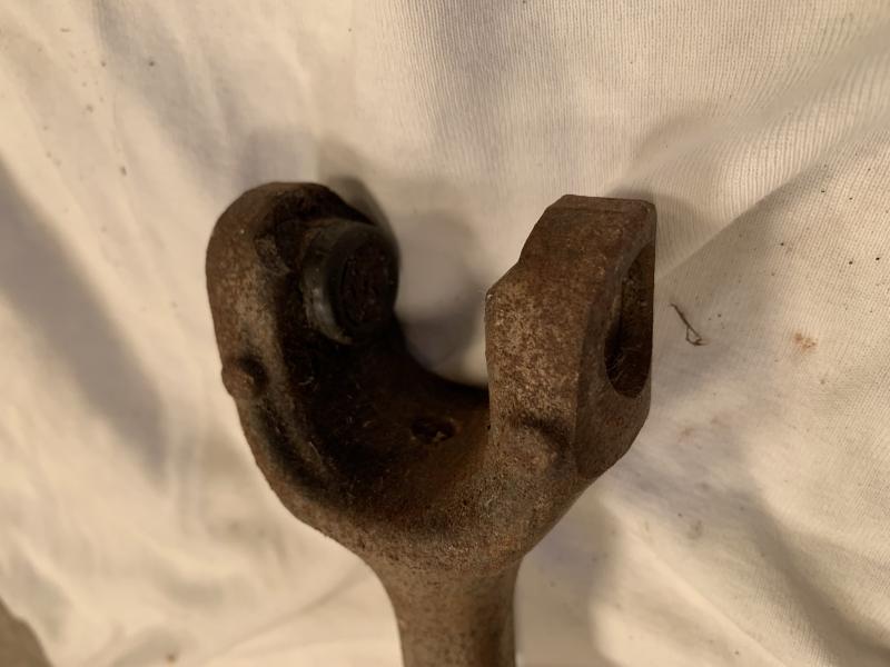

[image][/image]
File comment: Here are the pictures of the broken u-joint

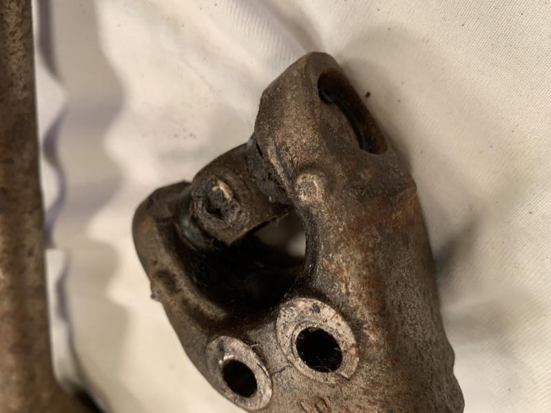

File comment: This is the non broken one but the circlip has come off and cap is poking out. Not sure if this was caused when the other one broke or if the wrong size circlip was used?

Here's the non broken one removed, it came out reasonably ok using a hammer and large diameter punch. Just need to clean it all up now and wait for the new ones to arrive.
