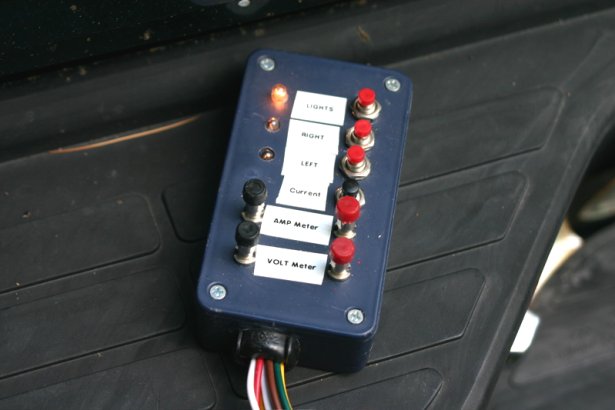

A few years back I built a trailer light tester.
This goes in line and have a few features.
There 12 lights that illuminate like the rear lights are suppose to.
You can measure teh voltage.
And Current draw. For this I had to use a switch to be abel to switch the meter into the circuit path. Not perfect since its the ground I open up. Ground is also provided via the ball and hitch.
But, this has 12 Volt inputs as well. So I can test the lights without a vehichle. With it a current draw reading is useful.
This thing does nothing more than organize teh trailer light wires/signals. Any volt meter can do the same.
But, if you think it will help you. Let me know.
If I were to build a new one of these. It would be different. Same principals different design.
File comment: The lights were On And the hazards were falshing.
File comment: You brake the four wire and put this tester in line.
File comment: Those black and red banana plugs can supply power from a battery or a power supply. And you push the buttons to illuminate.
