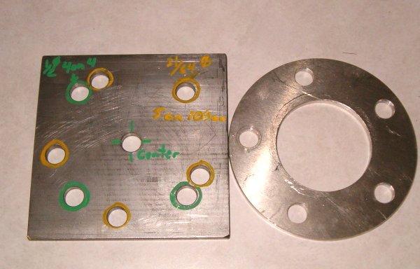

you can buy blanks from douglas as well, same price just have to drill, once you have a template for drilling machined, drill as many as you want, my car is 5/100, no wheels at all available, so i use 4/4 and have a template that was cnc drilled, bolt it on and drill the holes. :-)
template cost me 20 bux. :-)

That's a good tip, bugpac. I know you're located near me, where did you have the template made?
PostPosted: Mon Jul 03, 2006 10:37 am
Could'nt you just use the required hub, tap out the studs, and use the stud holes as the template.
PostPosted: Mon Jul 03, 2006 10:59 am
Posts: 251
you could, the biggest problem is getting centered, my template bolts into the original wheel holes, so its centered, well as centered as the manu drilled them, then i drill the new holes. when i had made i also had a 1/2 center hole, so i could get a blank wheel, problem is cutting the large center afterwards to look good, so i will just buy the 4/4 wheels and use my template.
Part on right is aluminum, it goes on after wheel, to cover up old holes and keep looking good.
Template is steel so the holes don't wobble out.

Jody made them, or protodie. he made the template and the two trim rings for me for 40.00 bux, i have been having a bunch of other stuff made tho, and that price may be a reflection on the rest as well. I need to have about 12 more of the trim rings made so i have them.
