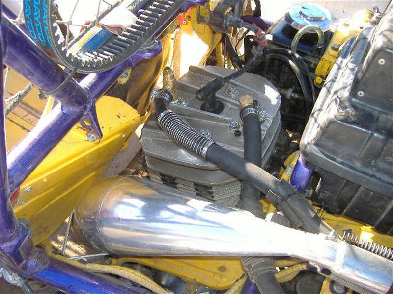

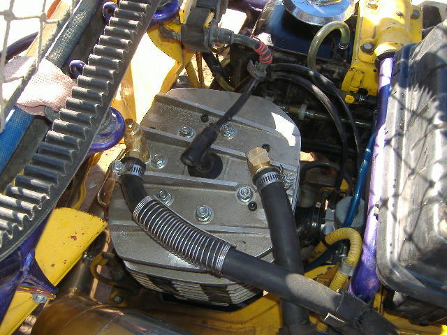

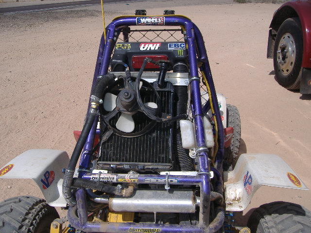

Why do you "feel" you need a pump, post some detail pics of your cooling loop from the head to the radiator.

front of head(car) to top of radiator. pix in camera I feel the hoses and way hot??? and sometimes one is hotter than the other. then vise versa the next time???

You really shouldn't need the pump. The hose going to the top of the radiator should always be hotter than the one coming out of the bottom.

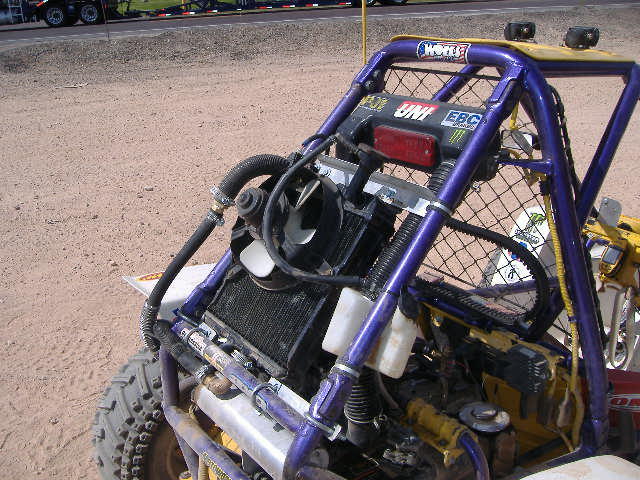

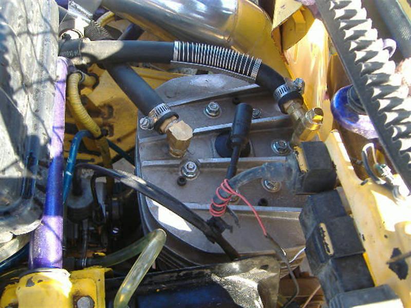

here are some pictures of radiator...
I would fix the intermittent fuel delivery problem ASAP or you will POOFKABBOOM the Engine again!!!!
http://pilotodyssey.com/sparkplug.htm
Why??? peace of mind!!!

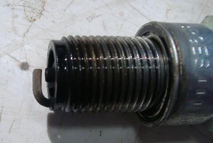

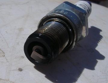

here are some plug chops from today... I like them, little on the rich side I think??? This is where I need to improve my skills, thus my confidence in this machine!!!

I didnt see anything alarming or drastically wrong with your plug pics but its hard to judge your jetting based on the pictures because their are so many variables starting with each camera takes a picture differently so the color could be off, I don't know if you let your Engine set and idle for 1/2 hr at some point in the plugs life or if your jetting is real super rich at one throttle position or another heck I am not sure if you did a WOT (Wide Open Throttle) plug chop or just idled in and then pulled the plug between rides.

DOH... Details let idle about 5-7 minutes... long enough to get it unloaded off the back of the trailer... then drove it about 5 minutes at mid throttle to warm it up and then went up a hill in the sand to watch my egt. (1050 to 1100) then brought it back to the parking lot to get a wide open throttle run, killed the Engine then coasted up to the truck, where the air hose is to clean out the plug hole!!!
