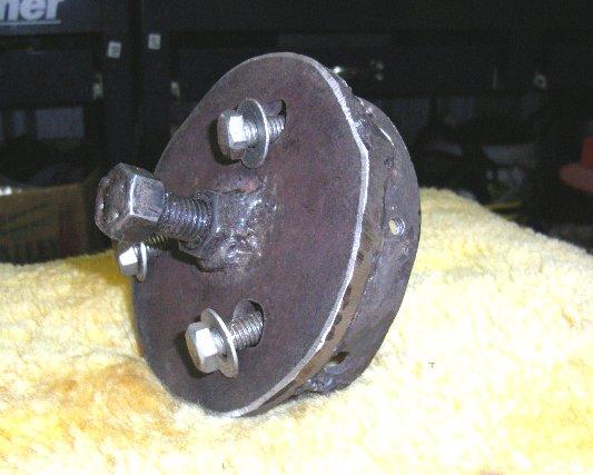

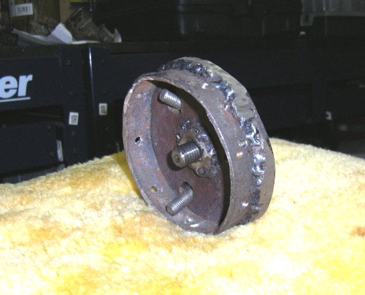

Here's what I made to pull the driven clutch off my 350 Ody after 3 days of wrestling with the #*+@%^! thing. Tap threads into the 3 holes on the clutch boss face,then fit the puller & bolt it up. Around the collar are a series of holes to take some self tapping screws into the boss curved side for added purchase/load sharing. Screw in center bolt while tapping gently on bolt head.Use lots of spray & heat.
PS. The dodgey welding was due to puller also being used as abstract art lounge ornament Shocked Would you believe earthquake! Smile Ba

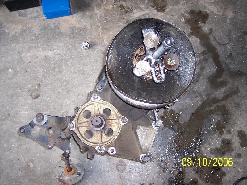

Okay guys, I've had it with that clutch. My plan did not work to hook up under the clutch and down to the bottom of a hydraulic jack. That 2 ton jack will not press it off, not from me. The pics of the puller above will not work either, I've already stripped the nuts off the bolts that poke through the clutch. The bolt just pulled right through the nuts. Anyway, my last ditch effort to solve this before going crazy on it...
Can I take apart the transmission with the clutch attached and will the cases come off of the shaft from the other side? If so, I could just take the shaft with clutch installed to a shop and they can press it off easily. They can't do it with the whole transmission attached. I have a manual but wanted to ask you all. Its the only thing holding me up and I'd appreciate your comments on this. Looks like if I go this route and take it all apart, I might as well rebuild it. Any comments on that too would be great. Thanks
PostPosted: Sun Sep 17, 2006 8:29 am
Have you made up a puller as per my pic? I don't understand when you say you have stripped the nuts off the bolts that poke thru the clutch.??? there are no nuts or bolts poking tru the clutch. Some pics of what you have done would be helpful. The puller needs to be made out of thick plate and the round collar needs to be self tapped to the curved edge of the boss of the driven clutch. I used about 8-10 self tappers thru the puller edge collar into the round boss of the clutch. As well you tap the 3 existing holes on the face of clutch. When i made mine and started to use it, it still took me 20-25 mins to get it off. The trick is to tighten up the 3 face bolts evenly,then tighten the 8-10 self tappers, then tighten the center puller bolt,then tap it firmly a few times,then tighten up again,ten tap etc. Mine only moved a" Poofteenth "at a time, but at least it came off eventually. I am confidant of this working. I wish you were in Perth and i would be right over to get it off. If all else fails i can post you my puller if you want. Cheers Baz

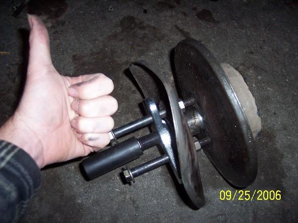

If you could post a few current pictures of the trans and clutch/input shaft then we could see what's left and maybe offer up some suggestions from that.
PostPosted: Mon Sep 18, 2006 11:55 am
Posts: 240
Location: Florida
here are the pics:
PostPosted: Mon Sep 18, 2006 12:16 pm
Posts: 240
Location: Florida
That puller looks like it is leaned over. It won't work properly when leaning like that. See how the washer heads are angled on the uphill section of the puller hub? Whenever possible I use pullers like that one inverted from the orientation you have there. Just unscrew it from the threaded shaft and flip it over and reinstall it. The other side of the puller is flat allowing the bolts to pull from the flat surface instead of angled as you have it there. You could probably put new bolts on the puller and put it back under tension and eventually the clutch it will come off, the question is when, and how long. Are you using an impact gun to tighten it? That makes a big difference over hand tightening. The impact helps to jar things loose. Since the clutch is already damaged and you have a spare ready to go you would not be out much by cutting it off of there. I would reset the puller and try it one more time, then I would cut it off if the puller did not work. Cutting is not the usually best option but will solve the problem quickly. I can't really tell if the movable face is damaged, but it may still be salvagable and a few other peices of the clutch as well, but the fixed face is toast for sure.

Bill, I"m going to try turning that puller the opposite of what I had it like you suggested and also use the next size larger bolts with 2 nuts on the end. I think if I take the propane torch and switch between heating it and using the impact, all that together might do the trick.

Yeah, keep cranking on it. At some point under enough tension that flange with the rivets where the bolts go through will crack and break off of there if the clutch does not break free first. If that happens then it will be to time to begin the cutting process. If it breaks just grind it down enough to slide the rest of the clutch parts off and remember to start the first cut above the keyway as I described in the other post. Do you have a 4 1/2" angle grinder?

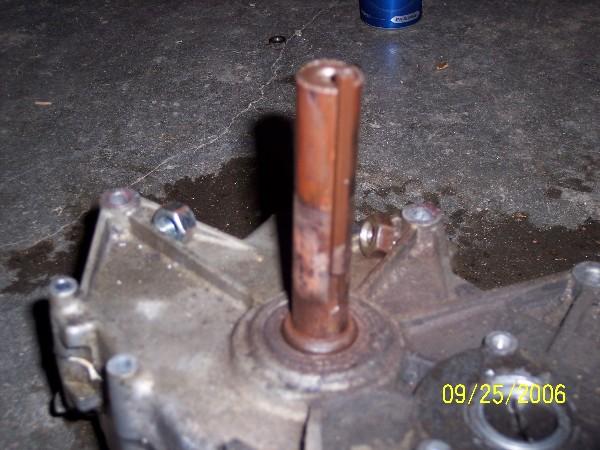

BTW I've gotten my clutch to come up about 1-1/2" to 2". Been heating the shaft with propane torch for about 5 minutes, then torque wrench. Its got grade 8 head bolts on the puller so those should take the stress. See I thought once I got that sucker broke free, it would just come right off. But it just as stubborn now as it were before. And now I can see were my puller threads are starting to strip. We'll see how it goes. I'll keep up to date. Thanks.
PostPosted: Sun Sep 24, 2006 8:05 pm
Posts: 240
Location: Florida
If you got it to move that's over half the battle. Spray some PB Blaster in there and see if it will seep all the way through. If so I would not heat it anymore and just hosing it with PB and keep loosening and tightening the puller. If it's moving it will come on off of there.

noskwik pics:
