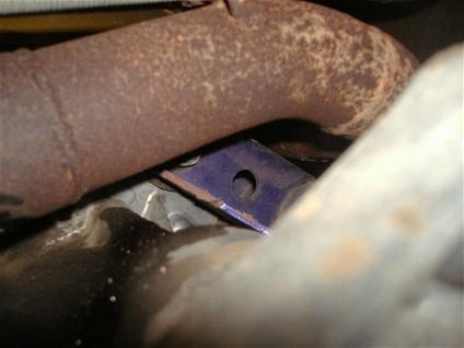

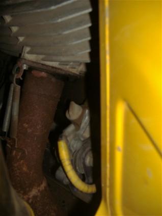

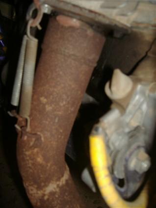

Some oil coming out of my exhaust maybe??? Real black, seems to be coming out of my exhaust but why???
Thanks David
Thanks David
First your exhaust is leaking and should not be, did you seal the joint with high temp silicone? http://pilotodyssey.com/Silconesealer.htm
Second at some point in your jetting you have a over rich condition the black muck you see is unburned gas/oil.
Hi Ho a jetting you need to go http://pilotodyssey.com/BillGivensjetting.htm
PostPosted: Fri Sep 15, 2006 3:23 am
Yea I guess I missed a spot on the sealant... I will remove clean and reseal...
A jetting we will get the hang of it soon. I was @ 1000 ft yesterday in AZ and 3750 todgo!!ay in El paso. I opened up the airscrew 1/2 turrn and she ran pretty good. I need to go to one of these meets ya'll have so I can have something to compare to... I am kind of a hands on guy!!!
