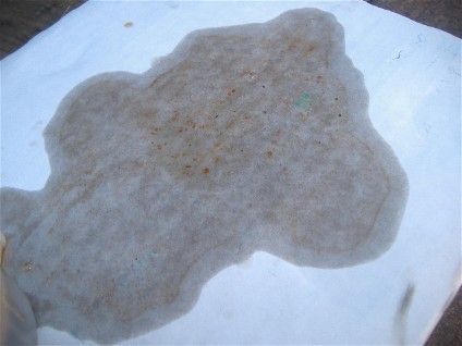

Remove the fuel filter and back flush it with carb cleaner see if anything comes out, if it has rust inside then fill it with carb cleaner and put your fingers over the openings and shake it up then pour it out on a paper towel until you get it as clean as you can.

First make sure you have some gas in the carb bowl(use a syringe or tiny funnel to add it to the fuel line to the carb). Next disconnect the fuel line from the pump out, then start the Engine and let it idle. Be sure you have some type of catch bottle to catch the pumped fuel. It should be gurgling out fairly heavily. If not, then do the fuel filter cleaning mentioned above. If the filter is plugged with rust particles, then you may need to have the tank boiled, Creamed or otherwise refreshed. If the filter is fine, then check the pump vacuum line from the crankcase. It may have loose clamps, holes, cuts or be cracked. The fitting behind the clutch is tough to check with the clutch installed.

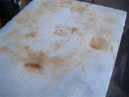

Well the easy way was what I chose to do today, since I am a long way from home... I bought a fuel filter from napa, and replace the OEM as a temp fix... I will order several OEM filters. I did the hoser clean out and as the pictures show we have rust!!
What is involved with the purgeing and preventing any new rust once purged???
Parts guy suggested taking to a radiator shop and dipping in acid??? but that kinda ruins the outide I would think???
File comment: Still wet and look at the size of these chunks...!!!
File comment: This is what it looked like after drying...
PostPosted: Tue Sep 26, 2006 12:36 am
