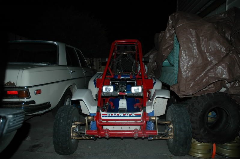

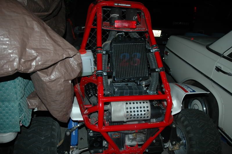

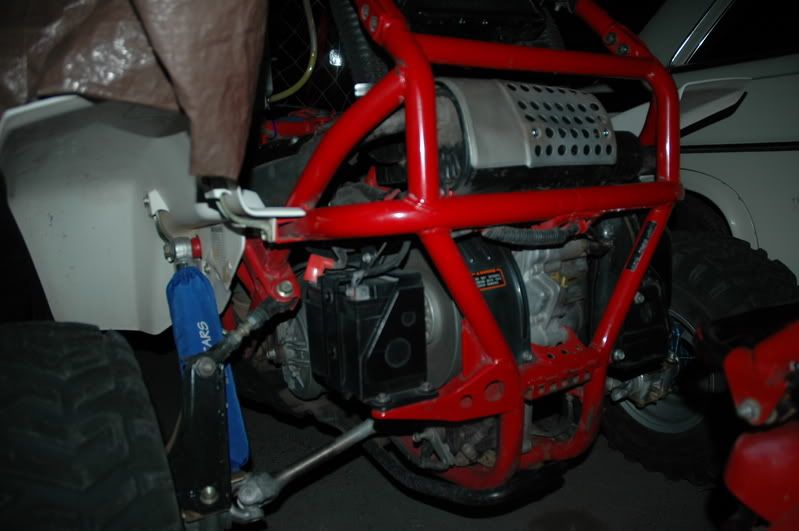

Ack its night when I get home, but here ya are. I'll take better ones in the day time tommorow.
