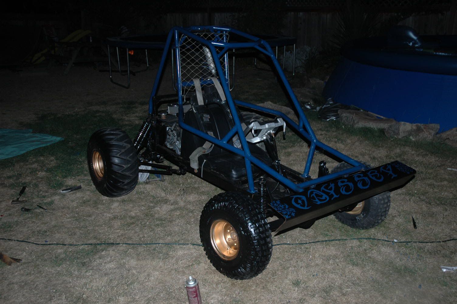

The cylinder looked fine to me, not all that bad. I have a pic of that too. I don't have a way to measure... hell I dunno if it is meaurable. Do you know how I can get new rings? Oh and also is a pic of my home-made wannabe Challenger...that needs a new axle still =\. I have 2 Odysseys and I cant even drive them. UGH!

Oh heres my Challenger Style Odyssey.
